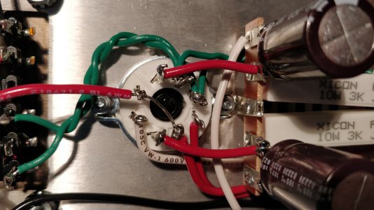

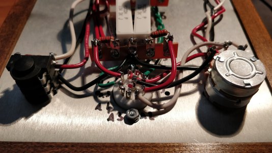

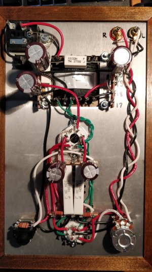

I don't know how useful they might be but I have uploaded some pictures of my kit, just in case someone might notice something wrong with it.

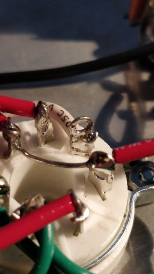

I have noticed that in my octal socket, which has two holes for each lug, I have only soldered the holes where a wire is passing. I'm not sure if I'm supposed to be soldering both, including the empty ones.

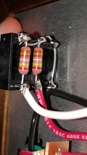

Two more pictures.

B4 doesn't look well soldered.
I would be willing to bet that the lug on the headphone jack where the black wires meet has one black wire that's not captured by solder.

I have resoldered B4 and checked the wirings on the headphone jack.
