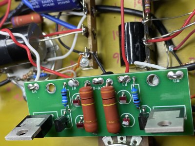

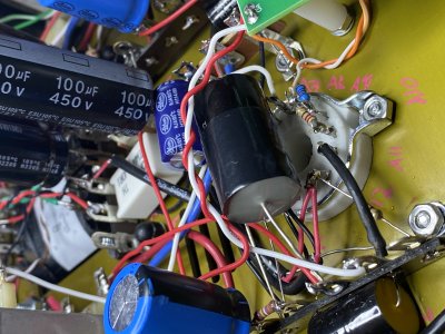

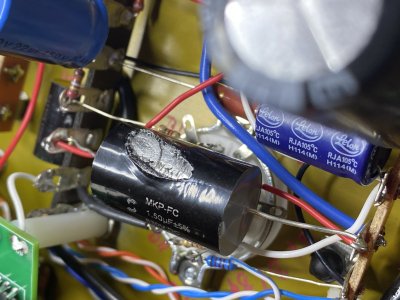

I just installed the C4S mod as per instructions (I think), and upon plugging in the amp to test voltages, I heard a loud crack. I quickly unplugged the amp and didn't see where the arc came from, but the Right Cap looks like it was damaged. The fuse remains intact. I have attached photos of the build. Not sure what happened. Do you see anything askew? Happy to take more pics.

It looks like in the first pic you laid the body of the iron against the cap and it could be directly shorted.

Yup that 1.5uF cap is toast. You need to replace it before doing anything else.

That thought did cross my mind but I didn’t notice it before I fired up the amp. I’ll send an email request.
