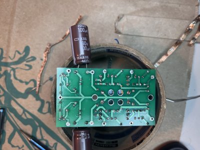

Reply #6 on: August 14, 2023, 07:10:11 AM
Paul,
Here is the most recent picture of the C4S board with the most recent attempts at resoldering.
    • Posts: 20245
Reply #7 on: August 15, 2023, 06:13:40 AM
That's a bit out of focus to really see everything.  To get all the terminals in focus, you'd need to have the camera parallel to the surface of the PC board and shoot it straight on.
Typically the problematic solder joints are the center legs of the MJE350.  Another problem arises when people don't see the LEDs lighting up, then decide that those are the problematic solder joints, then they reheat the LED joints until the LEDs are damaged, which then just adds another problem on top of what already exists.

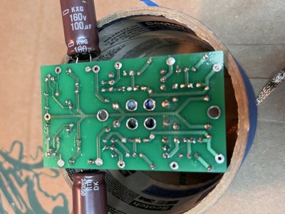

Reply #8 on: August 16, 2023, 04:51:23 AM
Hi Paul,
Here is another picture. Hopefully this is a little easier to see. Let me know if there are any glaring issues before I rewire the board back the the chassis.
    • Posts: 20245
Reply #9 on: August 17, 2023, 09:19:29 AM
I see a couple of joints in the top row of holes that look questionable.  If your iron has temperature adjustment, I would turn it all the way up.  Go ahead and reheat the center lug of each MJE350 and count to 5 to let the solder really flow out well.
