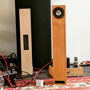

Yes, been meaning to do that. In crazy mode before Bonneville so things are a little disorganized. I've been listening to a new subwoofer prototype that Matt and I cooked up - see the photo. Pretty amazing for a tiny subwoofer. I am also convincing myself that the felt diffraction rings do make a difference. Was not sure at first, as I was listening in our dining room setup that is not treated. I now have the setup in the studio and I can dig a lot deeper into what I'm hearing. I am also experimenting with a zobel. It did not have a measurable effect in terms of frequency response, but I think I may hear a subtle improvement with it as well. If it stands up to more critical listening I will provide the parts to the beta builders to see what you all think.
I should emphasize that these drivers really do have a limit of about 5 watts max power as spec'd by the manufacturer. I have bottomed them a few times torture testing them above that level.

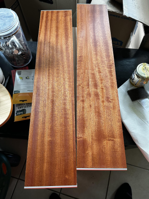

Alright, we’re underway! Put a coat of Odie’s on the cabinets. Really beautiful sapele ply. A little rough along the cut lines but I’ll survive. I resisted the urge to stain anything and just put a nice coat of oil on. I think these are going to be beautiful.

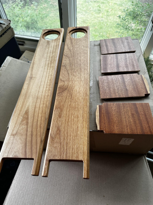

Speaker one is built. We had a slight parts mishap I’ll need to remedy tomorrow at Home Depot before speaker two can be completed. A couple thoughts:
  • A little spacer to set the gap between the floor and the bottom of the baffle might make alignment easier
  • I’m almost definitely going to want to take you all up on the custom base to have it stand up on its own
  • I may have overtightened the driver. Is there a way to tell? It’s not sitting proud of the front panel as the instructions indicated it would. Should I pull the driver and reset it?
  • By far the easiest Bottlehead kit assembly ever. Almost too easy, really! (Unless I ruined the driver by overtightening it)

Having trouble getting my photos to post, so here is an album from building the speaker. The corner locks are great!
