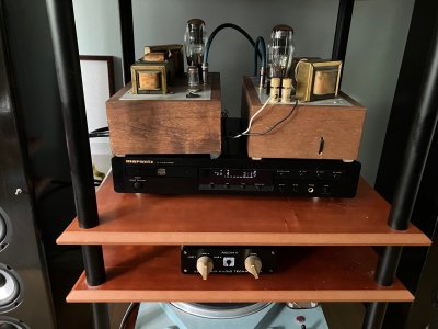

Hello,
Please forgive such a silly question from a first time poster.
I bought a pair of these a dozen years ago from the original builder, who helped me set them up.
They sounded fabulous but have been unused for some years through house moves etc, but now the kids are older and less likely (I hope) to damage them, I want to get them back into active service.
Can anyone here please advise me what they're called so I can dig out a manual & circuit diagram, or possibly let me know which of the speaker binding posts is the +ve one?

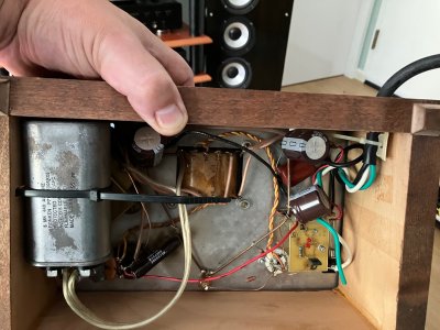

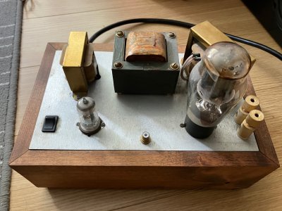

That's a Paraglow of some sort. There were several variations; a photo of the underside plus any identifying marks on the transformers will help identify exactly what you have.
I have some draft write-ups of these old designs and recommended adjustments, and PB has experience refurbishing/modifying them. We can help you get them running again.

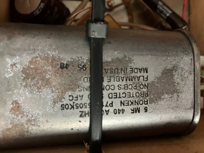

As suggested, here are a couple of pics showing the underside and details of the transformer.

Yes, that's a classic Paraglow, with a motor-run parafeed cap replacing the stock one. I don't see any other mods or complications.

With that confirmed, established that the +ve post is is the one in the corner of the chassis - or should be.
I wired and fired it up.
Some low hums while the tubes warmed up for 15 seconds or so, then super quiet and working perfectly so far as I can tell.
