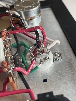

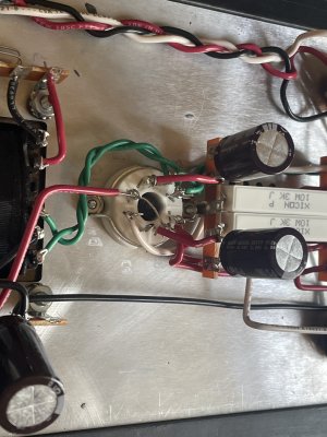

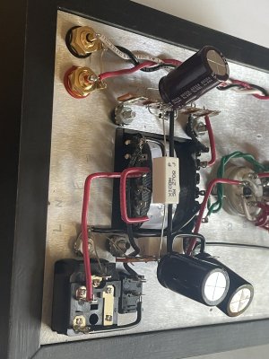

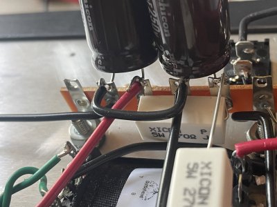

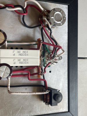

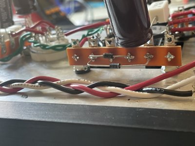

Offline EDick
    • Posts: 10
Reply #4 on: August 20, 2023, 11:28:49 AM
Sure thing, T15 & T21 read -0.634V & currently it looks like the tubes aren’t lighting up anymore. They were fine during the initial check and the 6080 is decently warm but not hot like under normal operation.
I took some pictures but I’m working on converting them so I can add those in a bit.
Offline EDick
    • Posts: 10
Reply #5 on: August 29, 2023, 02:45:48 PM
Howdy, I'm back with the pics. Sorry for the wait, was traveling. Thanks!
    • Posts: 20300
Reply #6 on: August 29, 2023, 03:01:48 PM
Power transformer terminal 11 red wire is not running to the correct position.  50/50 that this would cause your fuse to blow.
Offline EDick
    • Posts: 10
Reply #7 on: September 15, 2023, 05:41:00 AM
Lol wow, we must have totally missed that. Thanks so much, as always!
