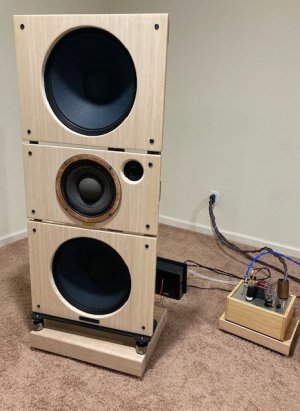

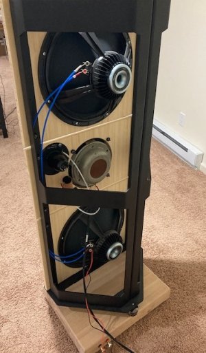

I run a custom Pure Audio Project (PAP) system with a pair of BH Paramount amps (see photos below).  I also bi-amp but at a very low crossover frequency using a pair of subwoofer plate amps.  In order to get you moving in the right direction, I/we need answers to these questions:

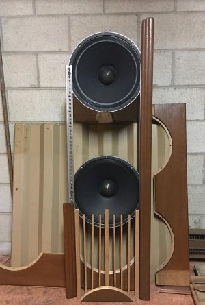

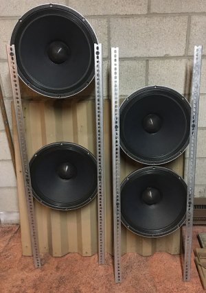

Regarding the OB speakers I'm building, here's a new pic.
This OB design will have minimum baffle width across the front. The baffle is instead wrapped around to the sides. In the pic, the width is about 16" and it's 55 1/2" tall to the top of the speaker. I'm liking the proportions, it kinda reminds me of a floor standing clock.
If there's interest and if it's allowed, I'll start a proper build thread.

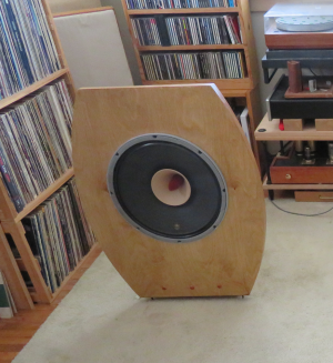

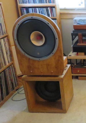

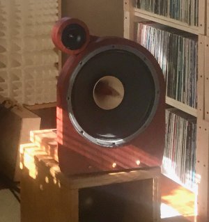

Larry,  can I see a picture of your F-15's?
Sure.  In fact, I'll show you three, in the order of their evolution in my listening room.
First photo: in their initial large barrel shaped baffles made from 3/4" Baltic birch ply.  Sounded great but not much bass below 60 Hz.
Second photo:  considerably slimmed down baffle set atop open baffle subwoofers (which are powered by plate amps),  Limited bass extension addressed. Plenty of bass now down to 30 Hz.
Third photo:  solid cherry baffle (1 1/2" thick) with added "supertweeters" to augment frequencies above 8K Hz.  This is the current configuration and I'm pretty happy with it.
I've been meaning to circle back with you and fire off a barrage of questions I have about those very cool custom speakers you have 8) I don't think I've seen another PAP with dual drivers mounted on a single baffle before. They look great :)
What wood are the baffles made of?
Are those the original PAP drivers I see there, or another of the Eminence Neos?
What drivers do you have on the mid-baffle?
Xover points?
Impedances of speakers/amps?
I kinda have a soft spot for the PAP. I ran across the project back when I was still doing basic research on OBs. At the time, their drivers were still available as line items and so I picked four of them up, as they seemed an easy OB bass solution.
