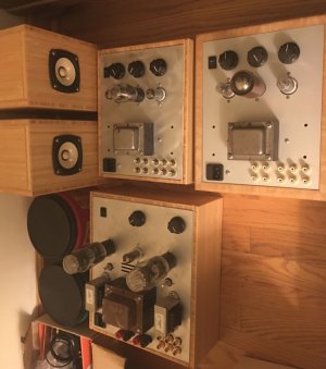

StereoEquipment1
The right Foreplay is the Prototype.
The left Foreplay is the last one sold.
The Stereomour is the last 120V sold.
Blumenstein Orcas cira 2012

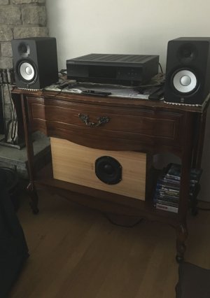

StereoEquipment2
Oppo UDP-205
Yamaha HS50-M Studio Monitors
Blumenstein sub cira 2012

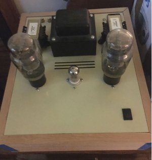

StereoMourMainsBuild
My first Stereomour

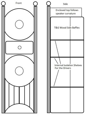

Researching OB designs again, I found information indicating that I could just wrap the baffle around to the sides :) Well this was news to me! I hadn't seen nor considered this before and got very excited about the possibilities, as some of the more functional OB designs I've seen (half sheets with a 3" driver) leave me a wee bit tepid. That being said, I do tip my hat to those adventurous souls who do partake and I can only imagine the WAF conversations that took place over having not just one, but TWO half-sheets of plywood dragged into the living room and left "Just three feet off the wall, honey, please!"
Anyways, I really like the "no wings" concept and already have a basic design in mind, see pic. It's really just a rather pedestrian "form follows function" progression of the basic and popular <lf driver> <hf driver> <lf driver> OB layout with some custom design features included.
Unless things change radically, I will use 48" 14ga perforated shelving steel as the frame. This makes vertical adjustments easy.
To hold the drivers more securely, I'll cut up the old baffles, rotate them 90 degrees, screw them to the steel frame and use them as cradles to mount the drivers. This may leave a small space on either side of the horn that I'll fill with wood. The width of the cabinet will be ~16".
Since the new baffles will be folded to the sides, I'll attach some horizontal shelves to them to isolate the lf drivers. The backs will obviously be left open.
I want the top of the cabinet to follow the curve of the 15" driver.
I may want the bottom speaker to have a curve-following bottom section instead of making it flat.
For testing, I'll enclose the front and sides right to the floor. It'll probably stay that way.
As far as the base itself goes, I'll just be temporarily screwing a couple pieces of 2x4 to the steel frame for testing. I'm still debating final design, but I have some 1" thick marble pieces to play with or I just may stack a few pieces of mahogany for a stepped look.
That's enough info for me to get the old baffles cut up and attached to the steel frames. For mounting the wood baffles to the frame, I'll install threaded inserts and use machine screws.

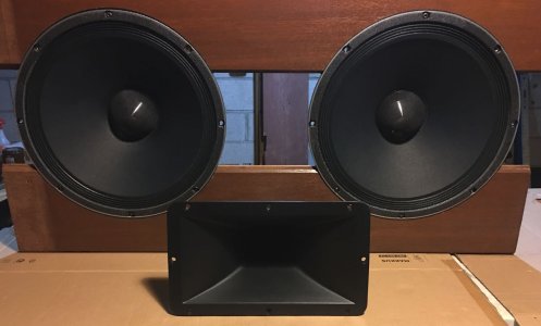

Compression Driver/horn (Heil replacement)
I ended up deciding to replace (instead of augmenting) the Heils, but replace them with what? I eventually chose a compression driver over another coaxial mostly because I thought that it would make cabinet design easier. I've also looked at cds in the past and and for a long time lusted after a set of TAD 2001s or updated JBLs with beryllium diaphrams, but couldn't afford them. When I started looking again recently, I found the Eminence N314-X driver that uses Textreme as the diaphram. Apparently it doesn't have the shrillness that's prone with titanium or the brittleness found with beryllium. Their waterfall plot shows they recover quickly with very little decay time. They have a recommended xover of 800Hz, just like the Heil does. This works well, as I have an ESS 800Hz xover to work with.  The horns are Eminence H14EA 60x40 Exponential. I'm a little concerned that the the dispersion pattern may be tight, but they were on sale :)
*Update:
The Eminence N314x-8s are out of stock, but the factory does have the 16 ohm version available, so I ended up canceling the 8 ohm order and special ordered a 16 ohm set through Parts Express. Josh@PE was very helpful with the process. As far as differences go, general concensus would say that the mids on the 16s will be slightly less forward then that of their 8 ohm counterparts, and that may be a good thing. The drivers should ship sometime in the coming week.
