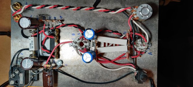

Definitely do not attempt to power up this amp.  Can you post some build photos?
Offline pyflaw
    • Posts: 9
Reply #4 on: September 14, 2023, 08:34:18 AM

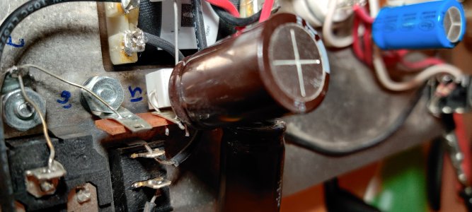

Let me know if you want to zoom in to certain part or take them from different angles.

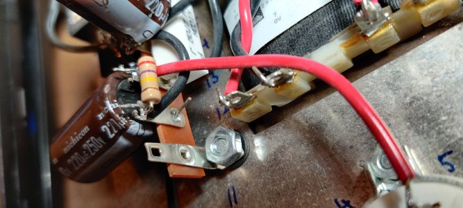

It's a bit difficult to see the connections of the 270 ohm 5W resistor that should be connected between terminals 13 and 15. I would double check those connections. If it is connected to the wrong terminals it could give the low reading you are seeing - for example maybe miswired to terminal 14 or 16 rather than terminal 15, or to terminal 12 rather than 13.

The leads of the 270 ohm 5W resistor (white rectangular resistor) are connected to 15L and 13L.

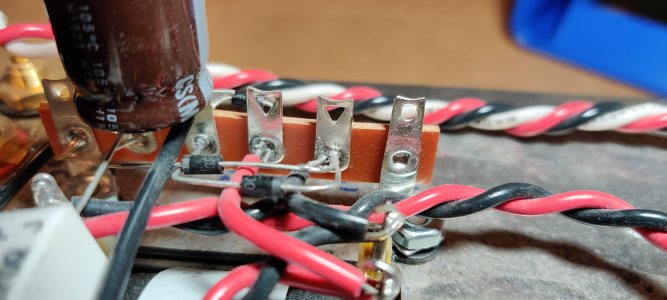

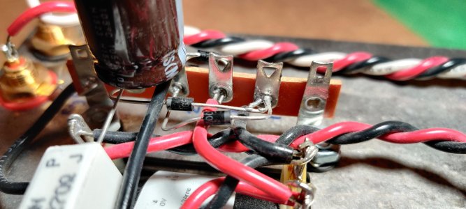

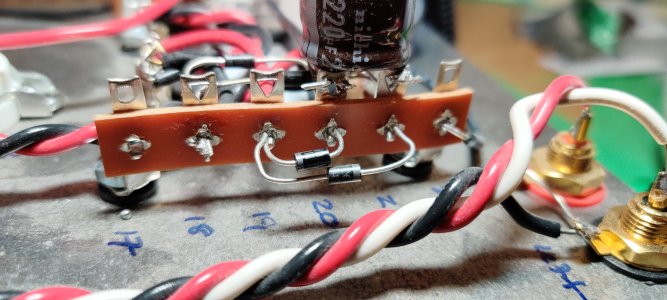

The diodes going to 21 and 22 look like they have their leads touching. The diode between 18 and 21 is out of position.  Even if this ends up not being your issue, those leads touching will cause major issues.  If they are touching, you'd expect terminal 13, B2, and B5 to be about 540 ohms...

The diodes that go from 19 to 20 and 19 to 21 (first photo) seem fine (not touching) but the diodes that go from 18 to 20 and 18 to 21 seem touching each other on the terminal 20 and 21 side (second photo). I have adjusted the leads to keep them away (third photo).
I remeasured the resistance at terminal 13. It is much higher now but it kept changing and did not seem to settle at a final value. It started with a high value like 8, 9 M ohm and went down slowly to may be around 1 M ohm and then jump to 10 to 20 k ohm and then went up in value to around 200 k ohm and then jump back to a couple of M ohm and then went down in value and kept on jumping back and forth. The terminals at B2 and B5 behaved the same way as terminal 13.

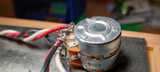

    • Posts: 20304
Reply #13 on: September 16, 2023, 03:37:38 PM

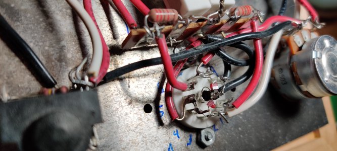

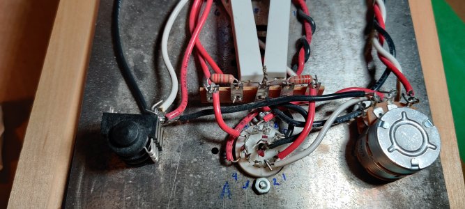

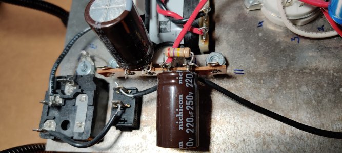

Could you post a closer shot of the 9 pin wiring?
Offline pyflaw
    • Posts: 9
Reply #14 on: September 16, 2023, 06:23:19 PM
Let me know if these are not sufficient or you would like to zoom in to certain pins or take it from different angles.
