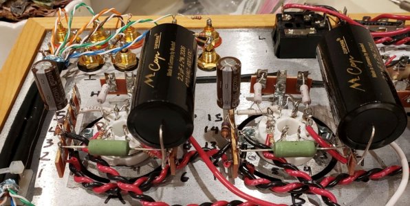

I've been very impressed with my Moreplay's performance in stock form, but I've decided to see what a cap upgrade can do.  From some of the reading so far, it seems that upgrading the 2.2uF output film caps is the way to go.  Am I right?
Unfortunately, while I'm great at soldering and following directions, I'm not sure which brand/type to choose.  I've heard about Auricap, Jupiter and Mundorf.  Just focusing on Mundorf for a second, I've found the following available at Parts Connexion:
Mcap EVO
Mcap EVO Oil
Mcap EVO SilverGoldOil
Mcap Supreme
Mcap Supreme EVO Oil Black SEO
Mcap Supreme EVO SilverGoldOil Black SESGO
Mcap Supreme SilverGold
Mcap Supreme SilverOil
Mcap ZN
The ZN is tin foil polypropylene, and all the rest are metalized aluminum/gold/silver.
Any advice as to which ones are standouts?  I don't really care about price.  Or, are the better options in another brand?

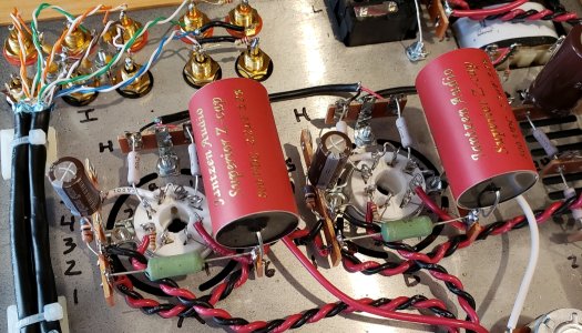

I have 2.2 Mundorfs in my Moreplay and upgraded to 16V ELNA Silmic II for the the 220uf caps. I have the Jantzen Superior-Z Caps in my SEX amp and they perform very well. I just ordered the 2.2uf Superior-Z's for the Moreplay to hear if there is any change compared to the Mundorfs. The Silver Jantzens look interesting but I'm not sure if they would be any better than the orange Superior-Z, which seems to be well liked from nearly all of my reading and experience with them.
The preamp is awesome as is (straight out of box parts) but fun to experiment if the cost is minimal in which this case it is.

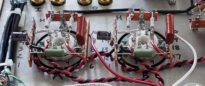

I heard a satisfying improvement when I replaced the stock coupling caps in my Moreplay with Auricaps.  Not earth-shaking, but noticeable.  More transparency and resolution.
