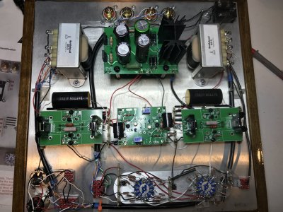

Hello All,
Can someone help me debug Breg voltage problem I am facing. So I passed all the resistance checks. Nothing remarkable except that terminals 19 and 30 read steady at 215.4 Kilo ohms and 208.8 kilo ohms. But after powering up first thing i noticed is that the LED's on the B-side of the C4S board connected to C-socket do not light up. All my voltages seems to be in spec (on a 120VAC connection) except for B-reg regulator board. These are the values I am reading.
+275VDC on Power Supply Board      274.7V
+6.3VDC on power supply board        57.7V
-6.3VDC on the power supply board    51.5V
IA on the A-side C4S board                274.3V
IA on the B side C4S Board                274.1V
Breg Regulator board:                       216V (A-side), 156.3V (B-side)
-reg regulator board                          0V both side
Kreg regulator board                         9.88V and 11.34V

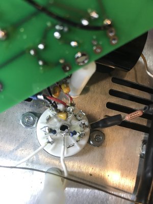

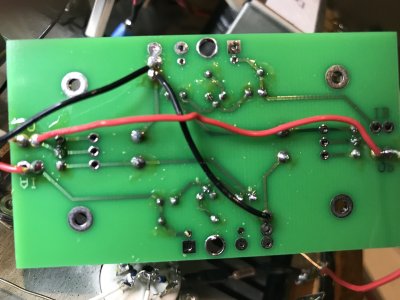

I have posted some build pics also.
Thanks in advance!

OA should not be wired to OB on the high current C4S board.
dang! this was such a blunder from my part .. careless  :'(
thank you for pointing this straight away PB! after fixing the glitch, everything is in spec now.. it is running now and sounding very good.. thank you once again!
