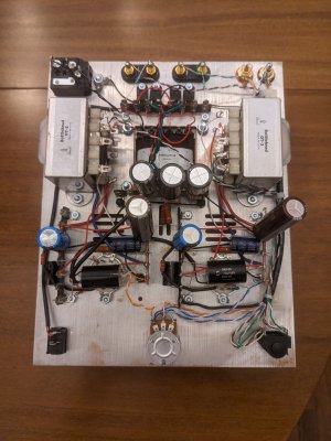

Reply #1 on: September 25, 2023, 08:13:07 AM
Posting photos of your build would be the best way to start troubleshooting this.
Offline burgerbassist
    • Posts: 18
Reply #2 on: September 26, 2023, 06:23:21 PM
Here you go!  Let me know if there's anything you'd like to see closer.

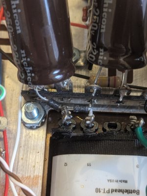

Reply #3 on: September 27, 2023, 07:31:52 AM
I'd like to see a shot of the UF4007 diodes and how they are connected.
    • Posts: 18
Reply #4 on: September 27, 2023, 08:02:46 AM
It looks like that's where the issue is - I accidentally soldered to 36U and 34L instead of 36U and 33L.
After I get it fixed, do you think this mistake likely has the potential to have caused larger issues that I may have to track down and fix?
    • Posts: 20299
Reply #5 on: September 27, 2023, 01:34:30 PM
No, thankfully that kind of mistake will just blow the fuse and the rest of the amp will be OK.
