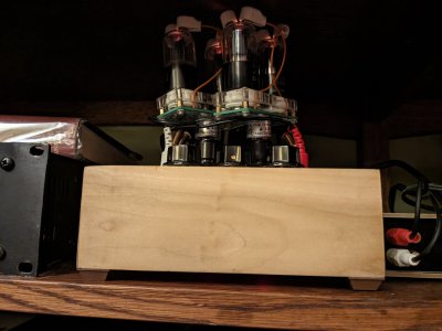

In January 2000 I bought an Electronic Tonalities Foreplay kit.
It sat in its box until about 2 weeks ago, but now I have a working preamplifier.
I'm pretty sure it's the messiest assembly and soldering job anyone ever did, but it works!

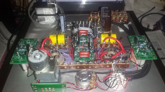

The top side looks just as sketchy as the underside.
Before building it I became charmed by the crazy look of the 7193 tubes and the internet says they sound great so I felt I had to use them.
I ordered 4 tubes and 2 adapters in ebay and was warned by the manufacturer of the adapters that they require 6.3V.
All I did was wire the heater connections of the 2 tube sockets in series and indeed that seems to work.
(In each socket, terminals 4 and 5 are connected and terminal 9 is connected between both sockets. The two 12.6V power cables each go to one of the 4=5 terminals.)
Other than that it's stock, with the anticipation and whispers upgrades.
Right now each tube adapter is sitting on a tower of 2 socket savers to clear the RCA connectors. Once I get some right-angle connectors all I need is a single socket saver on each side to clear the knobs and connectors.
Armin Haken

Reply #1 on: October 12, 2023, 04:36:56 PM
My attempt to post a photo:
Armin Haken

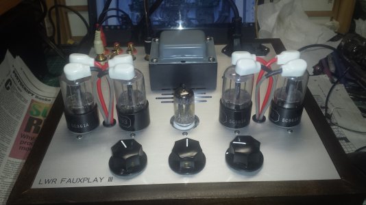

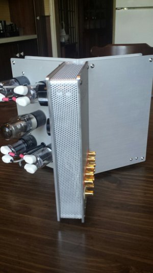

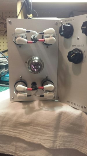

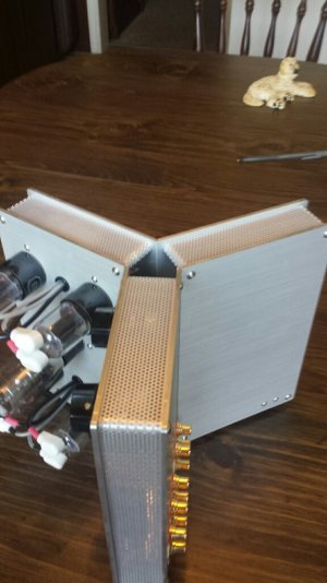

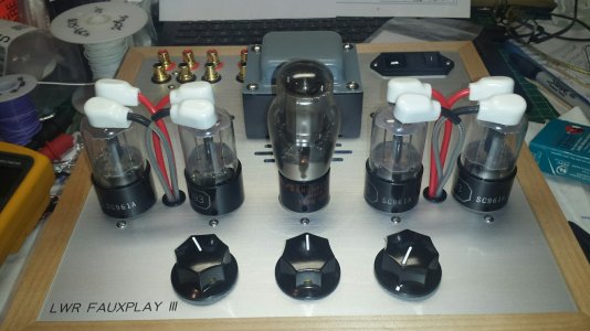

7193/2c22, 6j5's and e1148 tubes are similar and cool, pretty much 1/2 of a 6sn7 or 12au7.
here are a couple of preamps I built based on the Foreplay III platform.

Reply #3 on: October 12, 2023, 07:22:43 PM
Two 7193s draw as much heater current as two 12AU7s, and I am remembering that the power transformers on the Foreplay I and II didn't have much to spare.  You have four 7193s on there, so I would expect relatively short life from the power transformer running under those conditions.

I think a 12 wall wort would not be appropriate as the heaters require 6.3 Vac or Dc. a 12Vac center tapped transformer would be more appropriate. you could mount said trans on the wood base with dissamble connectors to make it easier to dissemble. I forgot to include a pic of the Faux play III that a nice fellow from Washington State sold me an original Foreplay III extended kit to me. Thank's you know who yuo are.

When using all 4 tubes, the 2C22 tubes were generating some hum that would disappear when I touched the wire to the top cap.
The 2C26 tubes do not have that issue. They have a bit less gain so I turn up the volume a bit but I think they sound really nice and clear.
Those tubes are also really cheap because nobody has any use for them.

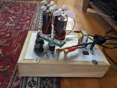

Here is a picture that shows the added input from the 6VDC power supply:
