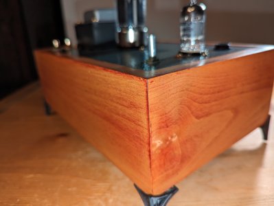

The Seam: The result of occupying all of the available space in a Crack.

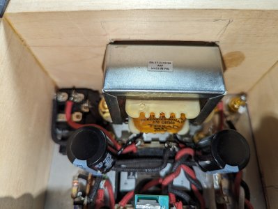

I stained the base fire engine red, sanded it back and then hand rubbed and polished 4 layers of tung oil. The inside of the case was then liberally excavated to provide enough room for the C-7X and Caps.

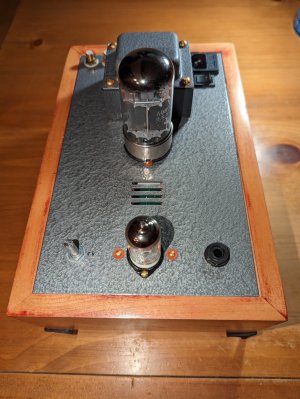

The top plate and TX cover are silver Rustoleum Hammer tone.
All of the hardware is brass.

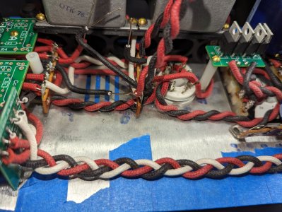

The wiring is 20 AWG Lacquered Cloth Solid Core. Because its just so pretty.

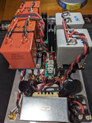

The C-7X is mounted on 1/2" spacers from the original chassis ground hole to right next to the RCAs.

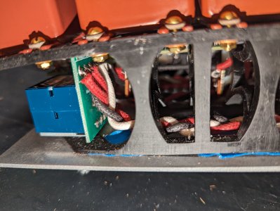

The cap mounts were modeled in Fusion and 3d Resin printed. They mount as a replacement for the TX isolation washers on one side and under the volume control and phono plug at the other. The clearance between the caps and the Speedball boards is tight.
Like all good Seams the caps sit a bit proud of the case bottom. So I modeled up some quick feet and resin printed them. They need some tweaking, but once I like them I'm going to cast them in AluBronze.
The silver caps are the last power supply filter cap @ ~60uf total. The red caps are the output caps again @ ~60uf total each pair.
I mounted the Cree diode PCB to an additional 1" standoff mounted to the TX side of the Octal socket.

Can I ask what the 3D Print resin type is that you've used? I've often thought about using 3D printed mounts under the hood of BH designs, but worried they'd start deforming pretty quick.
Simon N
Offline ssssly
    • Posts: 386
Reply #2 on: October 26, 2023, 05:58:50 AM
They are printed in plain Anycubic Black resin. In theory it's glass temp is 85C (never really tested it). But Ive used it successfully for engine intake manifolds. So I don't think the contact or ambient heat should be a problem.
And weight wise they seemed happy when I installed them. They are 5mm thick at the base and supports. Over an ~8" run of sprung I beam, back of the napkin...should hold ~50lbs+ in tension without deforming up to ~100C.
If it were PLA, ABS or even PETG, dunno. Probably a bit warm for thermoplastics other than the printable Nylon variants. Although you might be able to get away with PETG if it secured to the top plate and the bottom of the case. The heat of the top plate would soften thermoplastic enough that you'd need the cooler base support to hold stuff up once the amp was at operating temps.
