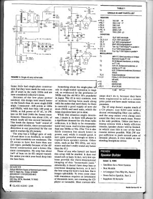

It was Eric Barbour in GA, here's a scan of one page
And you're right; almost 30 years ago, ancient history.....

Reply #4 on: October 27, 2023, 08:46:52 AM
The 6SN7 driving a #45 is a lot like our SR-45, but of course without the shunt regulated power supply that helps it sound so good.   The shared cathode bias resistor in that circuit is a big red flag, but again, this is from 1995 and things have progressed a bit.   Here's a short (and incomplete IMO) blurb from a completely different source on why one wouldn't want to do this:
https://www.jacmusic.com/techcorner/ERRORZ/One-Bias-Resistor/Index-One-Bias-Resistor.html
