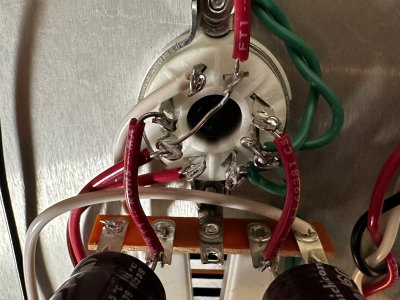

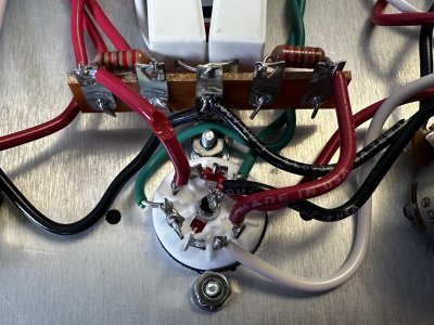

Hi all - finished building my Crack last night.  It passes all resistance checks, and all of the voltage checks EXCEPT terminals 1 and 7 both read 150 volts, and the LED attached to A8 does not glow (A3 is fine).

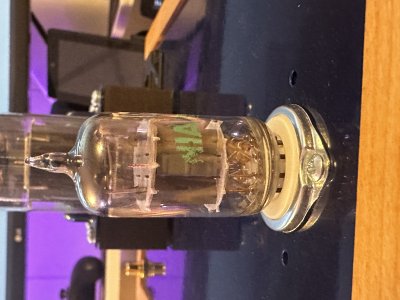

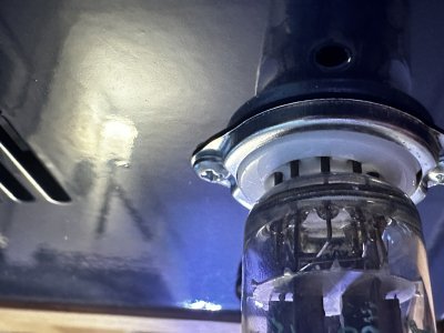

This is my first time working with tubes - the 6080 seated very nicely and flush, but I had a hard time getting the 12AU7 in very far - see pics.  I pressed firmly and wiggled, but couldn't get it to go in further, not sure if this is normal.
Thanks for the help!

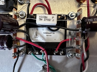

    • Posts: 20294
Reply #1 on: November 26, 2023, 12:42:47 PM
It looks like maybe you accidentally cut one of the UF-4007 diodes in the power supply.  Definitely you will want to fix this ASAP.
Can you carefully measure the DC voltage at A8?
