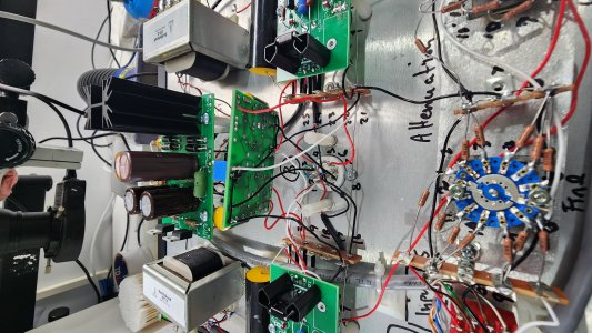

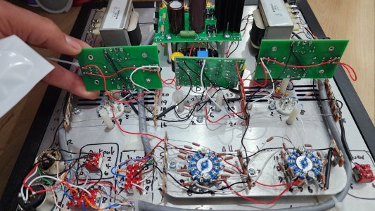

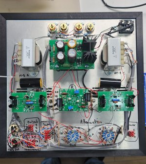

its one of your kit .someone gave it to me to build for them
in photo the one on left side c4 board doesnt light up led and voltage at OB is diffent(higher) than other board.
there is sound output but very quiet in headphones.
the right side c4 board two led light up

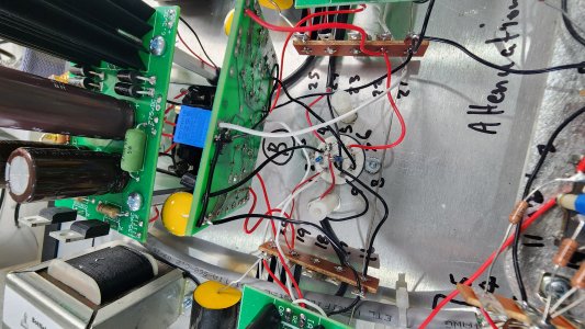

i just marked red r4 resister with marker as they were missing but later found and soldered.
voltrage A side +reg=306v
kREG 1.2v
B side +reg 218v
Kreg 4.18v
DC

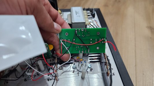

Reply #6 on: November 27, 2023, 04:20:21 PM
attached
    • Posts: 20290
Reply #7 on: November 28, 2023, 05:43:31 AM
Pin 1 on the center 9 pin socket should have a connection.

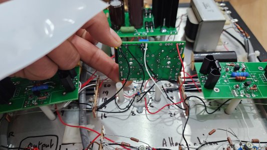

On the side where you were missing the red wire, a new 431 regulator will likely be required to get the regulated voltage to drop down.
Can you post a picture of the bottom of the center PC board up front?
Offline jagmeetbatth
    • Posts: 24
Reply #14 on: December 03, 2023, 11:05:04 AM
here?
