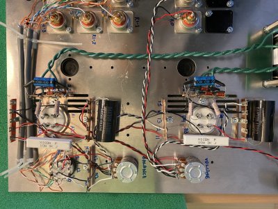

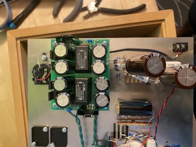

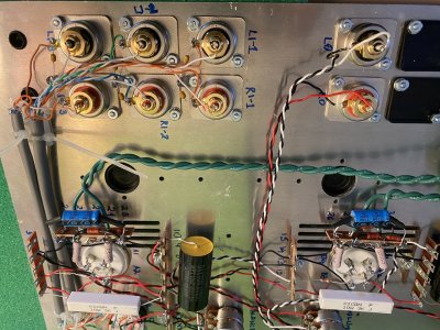

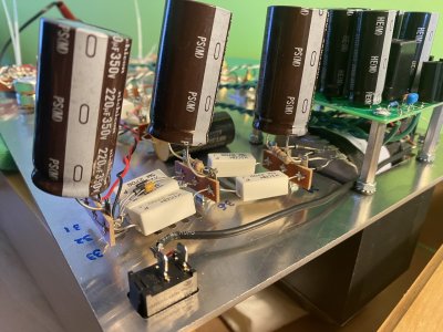

I've just completed a new BeePree2 build and hooked it up to discover the dreaded hum.
Currently going through and trying to find bad solder joints and the such and trying to reflow as many as I can. However I haven't been able to eliminate the hum/buzz yet
I've attached some build pictures to see if keener eyes can help me figure out whats going on.
- Hum is from both channels
- Hum increases with volume
- Preamp is hooked up to various solid state amps and speakers - hum exists on all of them
- Passed on voltage / resistance checks in the manual
I've also included a mov file with the audio of the noise if that helps
Thanks for your help
