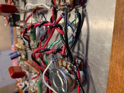

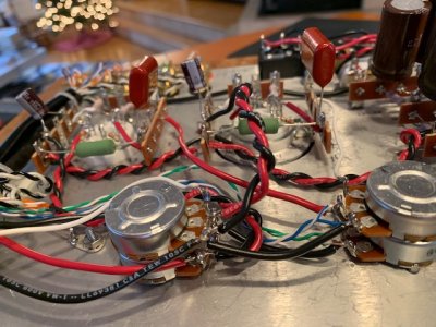

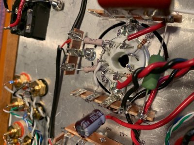

I recommend you post a picture that shows the connections between the volume pot and the balance pot. There might be a misconnection in the ground wires, the black ones between the two pots. Or maybe in the twisted red/black wires at T2/A6, so a second shot of the A socket wiring would also help.

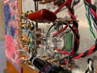

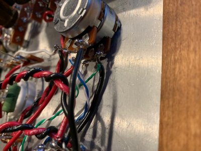

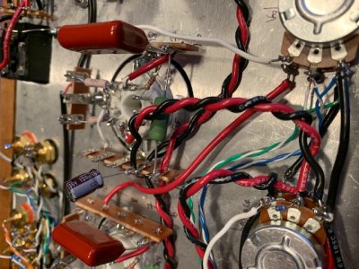

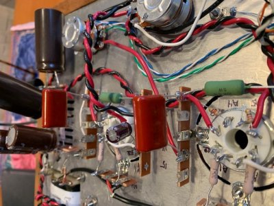

Do my pictures help you see what’s missing? I can’t seem to see what’s wrong.
- Sam
    • Posts: 20204
Reply #8 on: January 02, 2024, 05:55:43 AM
Yes, you are missing a black wire in your volume pot/balance pot wiring.

Can you tell me where? I have two: one connecting top near tabs and one connecting bottom rear balance to bottom front vol. I must be overlooking another, because I don’t see one in the manual.
Never mind. I see it. I have the twisted pair on the bottom of the balance pot on the wrong lugs.

While it looked like you were missing a wire between the volume and balance pots, what I actually see now is that the balance pot just isn't wired in correctly.
