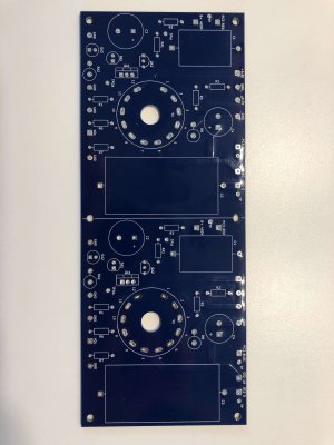

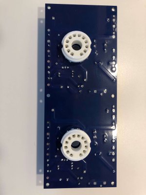

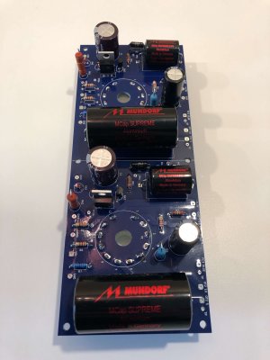

I will be using 2 boards for this project. 1 for the amp and 1 for the power supply. Both will be manufactured on 4oz copper with a 3mm trace width, except for the integrated C4S circuit which has 2mm traces. By my calculation this produces a copper cross sectional area equivalent to 21 gauge wire and should be a good proxy for the wire supplied with the kit, but this is an experiment for me and only time will tell.

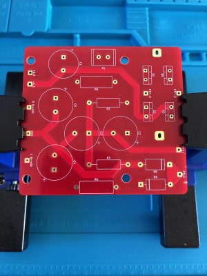

I ordered the board for the amp first as I wanted to see how it would turn out. Below are some photos of the board before and after population. I'm happy with the outcome so far and have ordered the power supply board. It should arrive in a week or two.

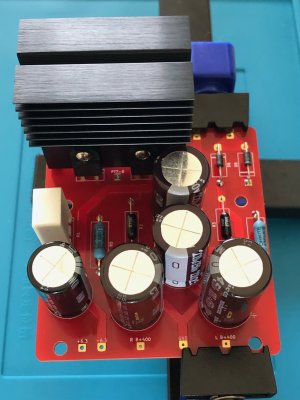

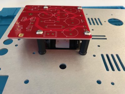

After a little back and forth over my gerber files my PCB for the power supply supply has arrived.
I remembered to put a radius on the corners this time.
This board has the same specifications as the amp board, with the exception that this one is immersion gold (enig) with 2U" thickness gold, versus the amp board which is HASL with lead. As far as production quality goes they both appear to be of the same standard.
Below pictures are self explanatory. Mounting position copied from the Mainline.

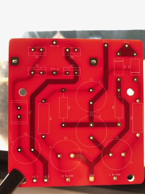

Here's a shot of the power supply board. The front and rear traces are the same width, though it doesn't look like it in the photo. The ground exits between the two +400V and is wired directly to the star ground point on the chassis plate. 0.1 ohm resistance from the ground point on the board to chassis ground or any ground point. The two B+ voltages are within a half volt of each other, as are the heater +/- voltages.
I also swapped the B+ output connections from left to right and ran the ground wire direct to the IEC ground point. No change, left channel still a slight hum. I also swapped the tubes between channels, no change, problem stays on the left channel.

Reply #11 on: March 30, 2024, 06:43:54 AM
I would not swap the output transformers, that's not going to do anything productive.  You may have to run the amp with the output transformer on the noisy channel unblolted and move it around to see if that makes a difference.  The plate choke may also need to be repositioned as well.   I could see your L B+ being a little noisier than the right, but that would give you 120Hz buzz, which it doesn't seem like you have (be sure to listen to a 60Hz and 120Hz tone to be sure you're identifying the sound properly).

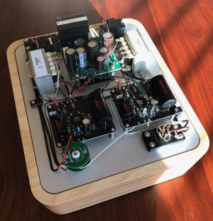

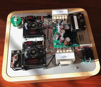

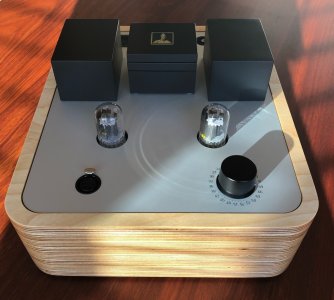

Finally got around to revisiting this project, to tackle the hum I had in one of the channels.
I reverted to the stock hardware layout. This gave me a lot more room to play with, so I split the amplifier circuit onto one board per channel and moved the 22uF caps and 8.2k resistors from the amplifier board to the power supply board. Up top I added some 3D printed polycarbonate covers for the plate chokes and......
Hum gone, sounds great.
Can't say which of the changes fixed the hum. I'm guessing it was probably the positioning of the iron.
Quite an expansive sound stage, possibly more than my Mainline?
I was wondering how warm the plate chokes were going to get under those covers, but after many long listening sessions the covers are barely warm to the touch.

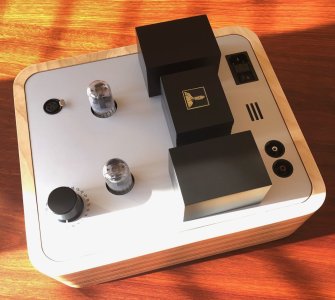

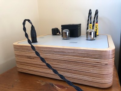

Project finished.
Final photos below.
