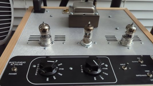

Please check the attached gif, in summary, when I turn on amp, the 12AU7 glows very bright for a moment then comes back to normal, as if it receives a very high power for a second.
Here is my resistance and voltage check that is not exactly matched what mentioned in the manual but within reasonable range:

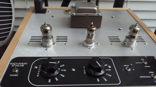

Looks like the attached gif doesn't work, here are screenshots. #1 is immediately after power is turned on, #3 is 2 second later.

It's can be described as normal or not unusual. European tubes apparently more prone to it. Nothing to worry about.
Google - 12AU7 flash on start up
    • Posts: 20203
Reply #3 on: January 08, 2024, 05:50:26 AM
That is likely a Mullard or an Amperex 12AU7, and the heaters flash a bit during startup for that particular tube.
Offline Mucker
    • Posts: 412
Reply #4 on: January 08, 2024, 12:38:55 PM
I have Tusgram 12AT7's in my Stereomour II that sure look like Mullards and they do the same brief flash on startup.
