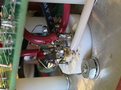

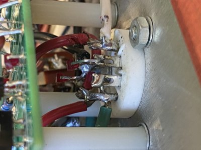

For the sake of thoroughness, here are photos of what my input tube socket soldered joints look like. I believe I see some areas of improvement in terms of soldering.

One thing that is not well understood in this hobby is that, while you may be able to easily spot a bad solder joint like a crystalized cold joint or one that was completely missed when soldering things up, you cannot look at a solder joint and know that it is good. Even if the solder looks shiny with a smooth fillet and covers the entire joint you can't know for sure that it is good underneath that unless you measure resistance at two points that are on either side of the joint, with the test lead tips explicitly not touching the solder joint itself. That way you are measuring the conductivity thru to joint from one component to the other. This is not always easy to do and oftimes it is a whole lot easier and faster to just reheat each joint until it flows well and cools to a shiny smooth joint - adding a tiny bit of solder when necessary. Then test to see if the issue has been resolved.
PB does all repair work these days. But when I did it - on a simple circuit like a Crack amp that was exhibiting any issue that seemed potentially related to connections I would take 5 to 10 minutes and reflow every joint on the amp. And the majority of the time this would fix the issue. This doesn't apply to our kits alone. I was having trouble this winter with cold starts with R-Ambo, my race hauler ambulance. It's a common issue and a dealer will happliy charge you $600 to replace the fuel injection control module to solve the problem. It turns out that the cause is exactly what we are talking about, a couple of bad solder joints that look perfectly good dropping the FICM voltage due to their increased resistance. The problem appears when the air temperature gets cold and the cause is heat cycle cracks in the solder that develop over time. Half an hour spent pulling the FICM out of the truck and reflowing those two resistor connections on a PC board had the cold start FICM voltage right back in the sweet spot. Even if a bad solder joint doesn't turn out to be the problem it should have been  checked and crossed off the list of suspects during troubleshooting.

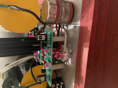

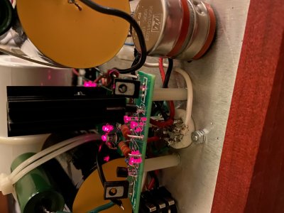

I finally found some time to look under the hood. First, I turned on my amp to do a chopstick test, and I noticed that my input socket LEDs are not lighting at all. I've included a photo to show. This is quite odd, because all I've done at this point is flip my amp over lol. It was working just fine except for the right channel buzz.
My chopstick test was negative.
What is the opinion on the input socket LEDs? The others light up just fine. I will say that since I installed the speedball, those LEDs were always dimmer, but never completely unlit.

Is the 12AU7 tube still glowing?

I would not use this amp until the issue is fixed.  The LEDs going out and the Speedball voltages going up like that means that the 12AU7 is no longer conducting.  100% there is a broken wire, unsoldered connection, or loose connection in there doing that.  You should be able to poke around with a wooden chopstick in order to figure out what needs to be poked to get those socket LEDs to come back on.
Whatever you do, don't just obsessively resolder the LEDs on the sockets themselves, as that is just going to damage the LEDs and it's most likely that your issue is elsewhere.
