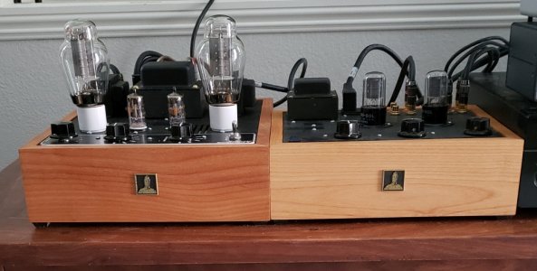

There are DAC's capable of >2V output. My Topping E70V can be configured for 2.5V RCA output (5V XLR out). If you are limited to 2V output, a buffer can help. I hear this is a good option but haven't messed with one.
https://neurochrome.com/products/universal-buffer
I use a Moreplay in between my sources and a Stereomour II and it does not color the sound at all and sounds fabulous. Stereomour has a MourQuiet in it with both postions at max (0dB) and the Moreplay volume control is used. Maybe give it a shot, you may be surprised.
