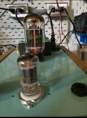

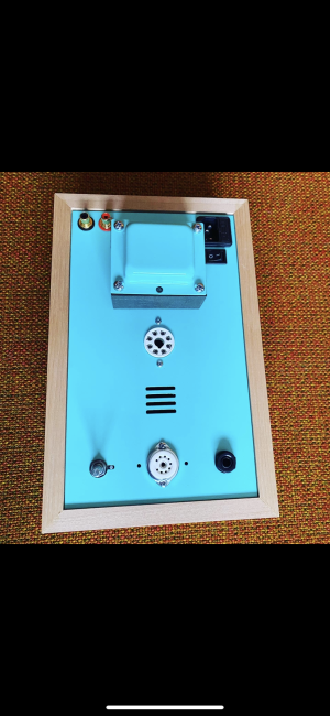

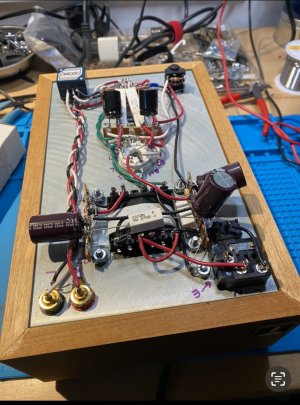

Spent almost a year building my Crack; I notoriously want to rush, so I spent a LONG time letting the spray paint and primer dry. Then I had to be calm enough to finish the second section of the soldering, so I waited. I have to say, I am proud of this build. My father was an electronics technician for his whole life and I felt that he would have finally been proud of me now that I am 50 years old! Ha ha ha.
I have this running with a Peachtree Audio Nova fed by a RP4 for Roon out to Senn HD6xx headphones and...the sound is glorious. 192khz files of Pink Floyd's "Animals" or Muddy Waters' "Folk Singer" came alive. I tried it in my main system, with less success (probably my sound flow with the AudioLab 6000A and the Pro-Ject turntable).

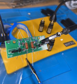

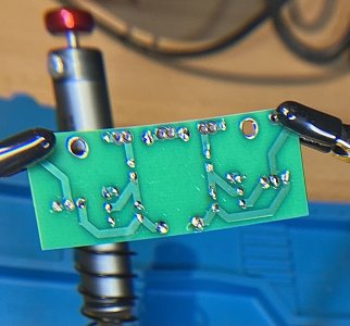

I am loading the PCB for the Speedball now, but had to order thinner 0.31 Kester solder over the 0.50 I used for the point to point work. I am reluctant to risk the sound, but I guess I can always go back if I am not a fan of the Speedball.
I want to build another kit for 2024, but am not sure if a Moreplay or an Eros 2 would be best as a second kit. Any thoughts? I am going with pink for the aluminum plate: sort of going with 1950s Fender Stratocaster colours.
Thanks for this forum. I love reading what is written here!

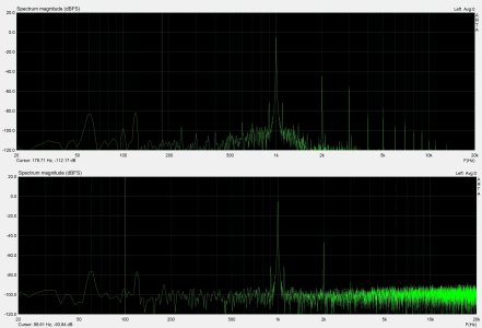

The big board allows more power from the output stage to be delivered to the headphones, as the output signal current doesn't have to be shared with a 3K resistor.  It would be surprising to find the large board having any kind of negative impact.

I recently collected some data on the kind of impact the small C4S board in the Crack has on triode operation.  The top here is a resistively loaded triode and under it is the same triode and the same operating point with a CCS.  You can observe that the second harmonic (what we refer to as the pleasant tube sound) is almost identical between the two, but the C4S loading has shoved out almost all of the higher order grunge and the third harmonic (not such pleasant distortion) has been reduced by 45dB and is almost invisible.  All those spikes beyond the third harmonic (3kHz) are higher order distortion that you really, really, really don't want in any quantity if at all possible, as they are rather unpleasant to the ears and come across as harshness.
Reply #11 on: February 06, 2024, 07:32:08 AM
Nicely done.
