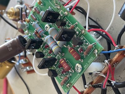

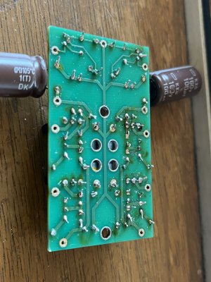

For something like this, it's helpful to post build photos.  Deviations like these are often cold solder joints, especially on the Q2 transistors on that center C4S board, but also sometimes around the 9 pin sockets. Occasionally something like a swapped R1 resistor can also cause similar problems.

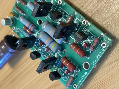

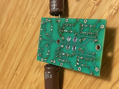

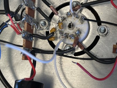

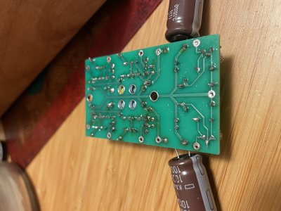

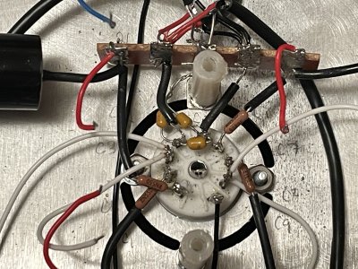

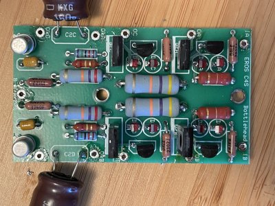

Thanks for the reply, Paul. I ended up removing the board and re-soldering all of the socket pins and anything else that looked questionable. After retesting, the voltage numbers are the exact same. I think the soldering looks OK on the Q2 transistors but I'm pretty new to this too. Anyways, i've attached some photos.

Reply #3 on: February 10, 2024, 01:37:23 PM

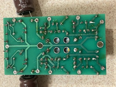

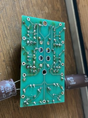

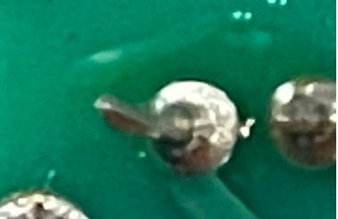

Can I see the bottom of that forward C4S board?

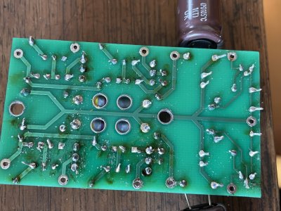

Reply #4 on: February 10, 2024, 03:29:12 PM
Sure thing.

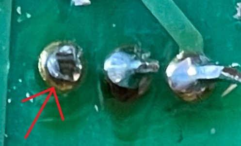

    • Posts: 20242
Reply #5 on: February 11, 2024, 07:21:39 AM
That's the kind of solder joint that you have to look out for.

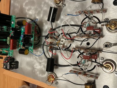

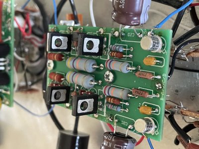

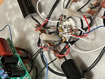

Reply #11 on: February 15, 2024, 04:24:37 PM
Can I see what the build looks like with that front C4S board removed?
Offline Nitsua08
    • Posts: 13
Reply #12 on: February 15, 2024, 04:38:35 PM
Sure thing.
    • Posts: 20242
Reply #13 on: February 16, 2024, 01:53:46 PM
I would try popping in a different 6922.  It has also been my experience repairing these that problematic solder joints can lead to situations that are unkind to the 6922.
