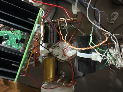

I am doing my first resistance check with the beepree.
The terminal 8 vs terminal 1 is yielding 0; like it is not connected.
Is there any pointers on where i should look?
Note: terminal 8 and terminal 16 yield 4.5 ohm.

Reply #1 on: February 17, 2024, 05:21:33 AM
Attached pic

Reply #2 on: February 17, 2024, 06:54:42 AM
See the second to the last step on page 35 of the manual.  Also be sure you didn't accidentally do the same thing on the other side.

Reply #3 on: February 17, 2024, 08:41:57 AM
