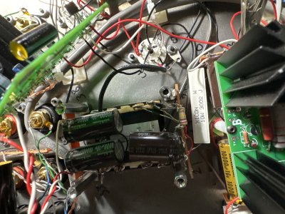

Hi,
Can you please take a look at this picture? I cannot find in the manual any black wires that goes to 26.
I do have a black wire that goes to 38.

    • Posts: 20173
Reply #4 on: April 21, 2024, 06:18:21 AM
Oh, you have a BeePre 1, that changes things a bit.  You can completely ignore what's going on at terminal 26 in a BeePre 1.  Not having 0 ohms here may just be a matter of having slightly loose hardware, but that on its own isn't going to cause and problems.
