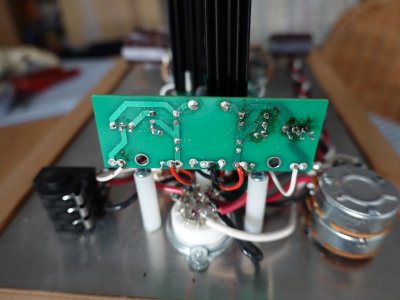

Could you post a picture of the bottom of your front C4S board?

Reply #7 on: May 24, 2024, 04:12:10 AM
By the front C4S board, do you mean the small green one?
Would this be correct?

    • Posts: 20250
Reply #8 on: May 24, 2024, 10:36:04 AM
One side of that board is not well soldered.

Reply #9 on: May 26, 2024, 10:28:25 AM
We went over the soldered spots again and the voltages have not changed

Reply #10 on: May 27, 2024, 08:30:40 AM
The 1.5V at both A3 and A8 in conjunction with the high voltage at OB on the small board would have me looking for pins touching on the bottom of that C4S board that shouldn't be, and also double checking that a 12AU7 is installed in the 9 pin socket.  The solder joints on the bottom of that PC board make it look like half of the components were replaced at a certain point, is that possibly related to what's going on?
Could you post some more photos of the build? (including the top side of the PC board)
