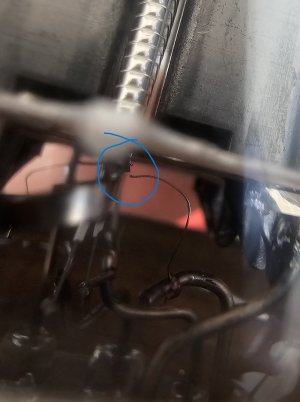

Reply #9 on: May 30, 2024, 02:51:23 PM
I'm still waiting on my replacement to arrive, but just wanted to update the thread here. I did a closer visual inspection of my current 6080, and found that this wire feeding into pin 6, connecting into terminal 9 looks pretty clearly busted. I'd call that a pretty conclusive root cause of my problem.

Reply #11 on: May 31, 2024, 03:30:35 PM
Interesting design to put the fuse inside the tube ....... whodda thunk?  :-*

Reply #12 on: May 31, 2024, 06:03:53 PM
Haha, if only this was as easy to repair as a normal fuse replacement. It's kinda frustrating that the only thing stopping this tube from working is, like, a 1mm gap on a tiny little wire. Oh well, guess I have a new desk ornament now.
