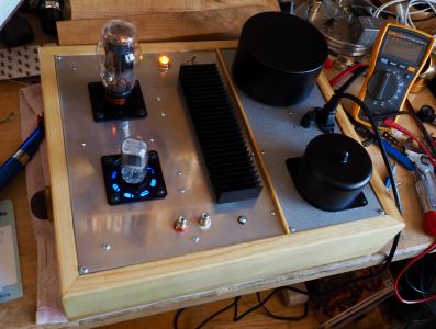

I've heard a Crack but don't own one.  I have both a S3X and a Crack-like OTL headphone amp based on Pete Millett's Wheatfield HA2 amp from the late 1990s (a circuit that I suspect influenced BH's development of the Crack). They sound different enough that neither makes the other superfluous.  You ask if someone could prefer the S3X to the Speedballess Crack (Slowballed Crack?) and I think the answer is yes.  The Crack-like OTL amp I built sounds sweeter than the S3X, but the S3X sounds snappier, more dynamic.  I like having both options available, but if I could only keep one, I'd keep the S3X, if only because I have low impedance Audezes as well as Sennheiser 800s that I occasionally like to listen to.

I gave away my HA-2 to a friend who now lives across the country, so I've never heard a stock HA-2 next to a Crack, but I have made 4 or 5 of my own versions of the HA-2 circuit over the years.  The latest one uses solid state rectification but keeps the choke.  As much as I love glowing tubes, I have to admit the solid state rectifier sounds better (I tried it both ways).  And I use blue LEDs to bias the input tube (instead of the resistor plus bypassed cap array Pete used on the HA-2: he bypassed the electrolytic bypass caps with 1uF Solen caps).
It sounds really, really good.  Not better than my S3X, but different.  A friend brought his modified Crack over to compare it my own modified HA-2 circuit, and he thought it was a draw.  I wasn't so sure.
I think the 6SN7 plays a big part in why I like the HA-2 circuit so much.  Plus, the 6AS7/6080 tube is pushed harder: 2K cathode resistors instead of the 3K used in Crack.  As Paul points out, that makes for one toasty chassis, so I have a hefty heatsink in mine.  I also decided to use a toroidal PT and choke because I just could not get the Hammond iron I'd been using to be quiet.
