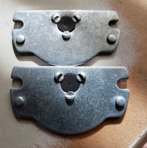

I once bought an SL-1210M5G from a DJ and it was in really decent shape but the stock thrust plate had a big dent in it. Apparently from a hard strike down on top of the spindle.Must been a helluva party that night. But the KAB repair restored it to new. It's also a great time to take the spindle apart and clean it good. Easy to figure it out.

Found the old photo of the thrust plate I mentioned earlier. The top is the damaged one, the bottom is a very low hour like new one. The KAB one is very much better. It just attaches with 2 bolts, easy swap.
