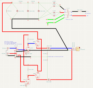

The input to 12AU7 grid (A2) is white.  From the terminal strip (5) (connected to 12AU7 plate A1) to 6080 grid (B4) is white, but from 12AU7 plate (A1) to the terminal strip (5) it is red. If this is not on purpose, I guess the first paragraph, has to be white wire. This is correct for the red channel, always red wire is mentioned.

I was working on a diagram showing roughly both the schematic and wiring points, it is attached, not fully checked yet, there can be mistakes. The points I made above can be seen in the diagram on the blue channel. I used blue color instead of white for visibility.

All connections to the tube plates in the Crack are made with red wire, denoting that these wires carry the highest voltages.
OK, that makes sense, but B6 to terminal 9 is also red.

Yes, you are welcome to use a piece of white wire there if you prefer.
