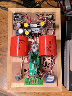

Sorry, I can't help with those. In some other thread, Doc recommended using Audyn Q4's as being value matched with the Crack, so that's what I used. I've be happy with them.
