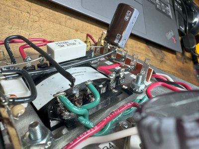

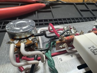

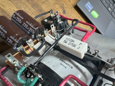

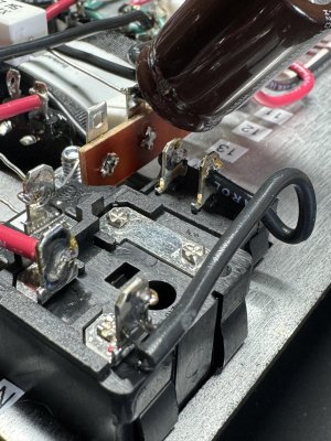

After getting the voltages sorted, Ive been using the amp for quite a few hours between yesterday and today. Sounds absolutely amazing, but I noticed that there is a slight static and crackling sound coming from the left channel. Its very faint and only audible when there is dead silence. Almost sounds like turntable static. I have tried a different  6080 and 12AU7 tubes and that didnt make a difference. I then was going to unplug the RCAs and swap them to see if the noise happened in right channel. But when I unplugged the RCAs, there was still the static/crackle coming from the left channel without the cables being plugged in. I tried re-soldering all the contacts on the headphone jack and that didnt seem to make a difference either. I also tried different headphones and a different cable. No change.
Here is a pic for reference, any ideas?

What wattage is your soldering iron?  What kind of solder are you using?
This is either a cold iron, lead free solder, or just not enough dwell time with the iron to get the solder to flow out properly.
Do note that the LEDs and power switch are sensitive to being overheated, so I do not recommend reflowing those joints unless you are able to spot a specific issue.

I used a Hakko FX888D-23BY iron @ 750 degrees. I believe this unit is 70w. I used Cardas Audio Quad Eutectic Solder.
Is there specific terminals I should reflow?

I would go into the manual for the FX888 and examine the instructions for raising the temperature vs. the instructions for calibrating the probe.  It's so easy to think you're cranking up the temperature on the iron when instead you are calibrating the probe and telling the iron it's hotter than it actually is. Once armed with this information, I would set it to 899 degrees for reflowing your joints.

ok, ill do that. do you recommend i reflow every joint (with the exception of the power switch and LEDs) or just the joints for the left channel?
also - should i add solder, or just reflow with whats on there already?

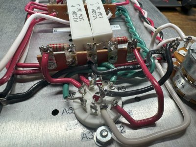

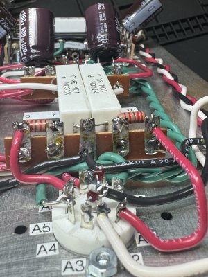

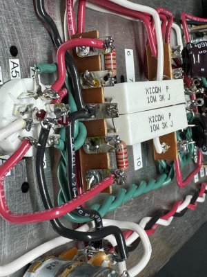

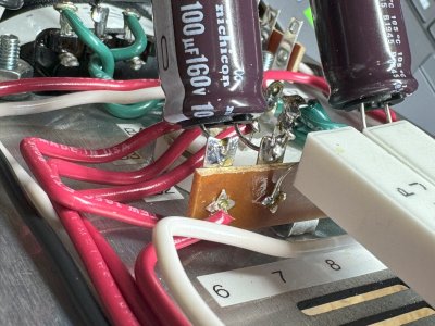

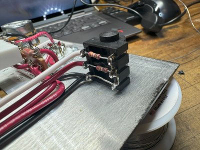

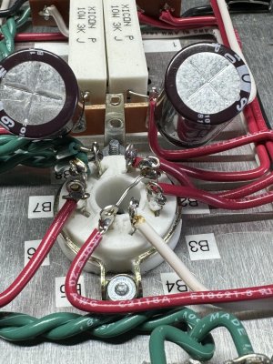

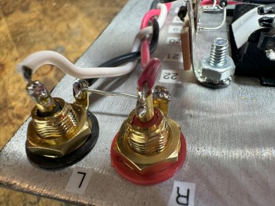

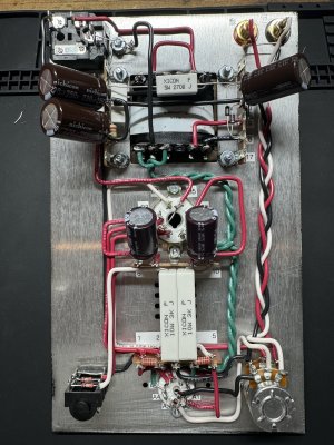

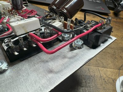

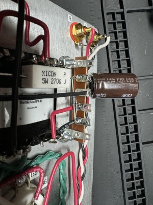

I tried to reflow and add solder to joints that looked like they could've used a little more and Im still hearing the crackle.
here are some more detailed pics.
    • Posts: 19744
Reply #6 on: July 10, 2024, 11:44:15 AM

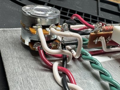

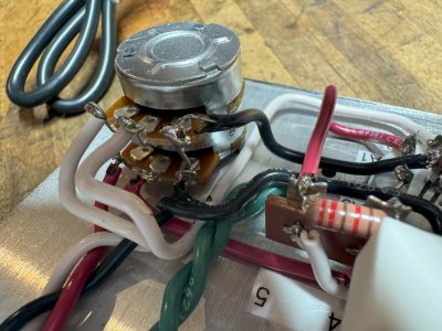

I see at least one black wire on the volume pot that doesn't look like solder has flowed around it.  The same goes for at least one of the white wires on the pot.  Were you able to turn the iron up to 899?
5U and 5L could use a little more heat to really flow out all the way.

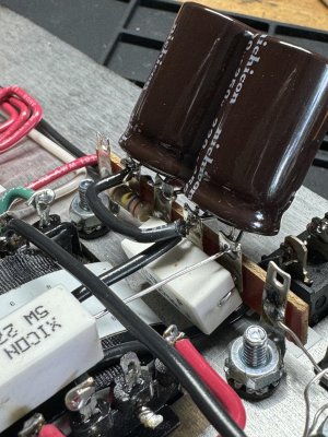

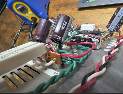

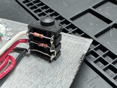

Yes, I got the iron up to 899. I reflowed and add a little solder to 5U/5L and the black leads on the volume pot. Still have the static.
here are the after pics.

no chance this an issue with the jack itself?
Offline Mucker
    • Posts: 392
Reply #14 on: July 11, 2024, 03:18:46 PM
It's entirely possible it has to do with the jack. Usually the black wires there are normally the culprit. Maybe try moving them around, adjusting them while the heat is on. Plus make sure all the wires at terminal 3 are secured well.
