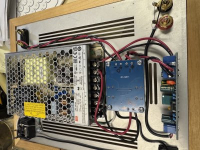

So my build passed the voltage test and the LED lights are all working, and all connections appear to me solid, but there is no sound to the subwoofer at all, even when I crank up the volume and crossover on the sub amp.

Are you using this Sublime with a Subette subwoofer? Have you tested the subwoofer with another amp to make sure it is working properly? That would probably be a good thing to verify before diving into the amp.
Also, the Sublime binding posts can be a little finicky. If you are using spade lugs on your speaker cable you might need to adjust the way they sit around the posts to make good contact with them.
The first thing to check in the amp is that all of the screw terminal connections are good. It is possible to have the wire in the hole in such a way that it isn't making good contact. You might just wiggle each connection a little bit to verify that they are all snug.

Yes, I used the subette with a dayton plate amp with no issues. I checked all the screw terminal connections and all are solid. I might need to pull the whole thing apart and rebuild it because I can't find where the issue is. Thanks!

Don't do that. A better approach is to use a little detective work. You said all the LEDs light up so it seems the circuit is working, and the wiring all looks good in the picture. So it is most likely an issue somewhere in the signal path. First try connecting the subwoofer up again and see if you hear a slight pop or tick when you turn the amp on. Let us know the result and then we will go to the next step.

Finally got the chance to get into this project. Turned the amp up, all connected (speaker wire to the subette; spades from amp speaker connector to RCA on sublime), blue LED lights glowing.
No pop or tick. Still no sound from the subette. I've double checked all connections and they appear fine...

I'm at home but when I get in to the office later I can come up with a test procedure if you would like to try it. Not to harp on it but we do find that the binding posts we use can be a little tricky to get good contact. Every once in a while when I am swapping gear I have to fiddle with the position of the speaker cable ends on the posts to get sound out.
The modular nature of this kit and every board seemingly getting power (all LEDs lit) leaves just a couple of options.
We could trace signal going through the amp to see where it stops. That would localize the issue precisely, but it requires the use of a signal source and a meter to track the signal thru the circuit. I'm thinking we would simply test at the output of each board and at the bindng posts.
The second approach would be to send out a new amp board and see if that solves the probem. Pretty easy to swap. If it did not fix it we would need to perhaps try replacing the preamp/filter board. If that doesn't do it we would need to figure out what connections are bad., which kind of takes us back to the first approach.

It occurred to me if my connections from the Stereomour II outputs to the Sublime inputs are the issue? I am currently connecting it as Stereomour II output (spade) to Sublime input (RCA). I was reading online that the amp output is high level and the RCA input is low level. Is this perhaps the issue?

While that can be an issue, the output level of a small SET amp like the 2A3 is roughly on par with line level signal.
The binding posts we use aren't always agreeable with spades though, so you could try slipping a bit of extra bare wire through the hole in the binding post to help make that connection.
