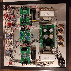

I have completed my resistance check and everything checked normal, but I'm a bit confused on the ones marked *. And I'm getting a measurement on 19. What I observed is:
Terminal - comments
12 - On 2000k multimeter I get nothing. Just stays at 1 (doesn't read 0Ohm thankfully)
14 - Same comment as above 12 Terminal
17 - Same comment as above 12 Terminal
19 - On 2000k multimeter I get 219
20 - Same comment as above 12 Terminal
22 - Same comment as above 12 Terminal
24 - Same comment as above 12 Terminal
29 - Same comment as above 12 Terminal
30 - Same comment as above 12 Terminal
Photos of my build attached. I wanted to double check this before I move to voltage.
Is the 219 219 ohms, or 219k ohms?
Offline Coldsnap
    • Posts: 18
Hi Doc B., it reads 219 ohms when my Multimeter is set to 2000k ohms.
Offline Coldsnap
    • Posts: 18
All my voltages measure perfectly, so guessing it's A-Ok.
    • Posts: 20294
That would be 219K.
Offline Coldsnap
    • Posts: 18
That would be 219K.
Thanks, any concerns here? My voltages measured spot on.
    • Posts: 20294
Also, the values signified with a * are going
to vary from ohmmeter to ohmmeter because these terminals are connected to the filter
capacitors, which try to charge themselves off the battery in the meter, causing a fluctuating
reading. If the circuit is connected properly these readings will wander in the tens or hundreds of
Kohms or higher range. What you want to watch out for is a zero reading at one of these
terminals, which would indicate that something is mis-wired.
