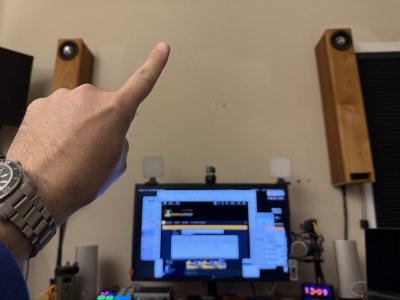

thoughts on hanging the subette horizontal above my pipettes? or should it be lower to the ground? pic for reference
    • Posts: 9765
Reply #3 on: November 27, 2024, 05:01:26 PM
It should be OK. The thing about subwoofers is that they produce sound at wavelengths that are in the same general magnitude as room dimensions. Because of this they can activate room modes - resonances that can be boomy sounding. Every room is going to have a different set of places where certain bass frequencies might get louder or softer if the subwoofer is located there. So the best way to approach subwoofer placement is to try it in a spot and see how it sounds. If it seems to be boomy or sucked out at a certain bass frequency you can try moving it a foot or so to see if that resolves the issue. You might want to have someone hold the sub up to the wall where you are thinking of hanging it and seeing how it sounds at your listening position before you hang the speaker permanently.
In theory you might want the sub to sit slighty off center both vertically and horizontally so you don't activate the most obvious side wall-to-side wall and floor-to-ceiling modes. But a theory is just a theory and you really need to try it out and see how it sounds
