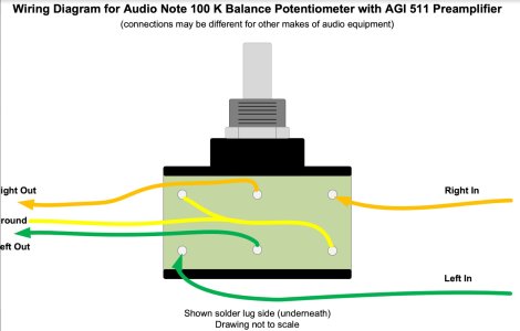

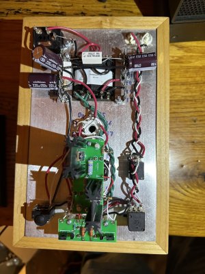

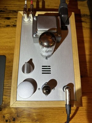

Reply #6 on: August 30, 2024, 06:51:49 PM
Success!  Thanks y'all.  8)
The audio note balance pot ain't cheap, but I gotta say I really like the center position feature it has compared to using a regular pot for this purpose.  Parts Connexion was also quick to provide a wiring diagram specific to this pot.
