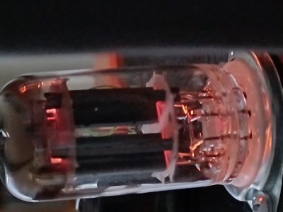

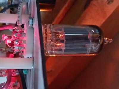

Lit means illuminated, are the LEDs on the 9 pin socket glowing?
Are both halves of the 12AU7 still glowing?
If the answer to both of those questions is yes, often times you just need to reflow the solder joint on the center leg of the MJE350.

Yes, both 9-pin socket LEDs are glowing and both halves of the 12AU7 are still glowing. Not very brightly - the larger valve is much brighter - but they are - see pics attached. Also, all four LEDs on the Small Board ARE glowing (tricky to see, but they are).

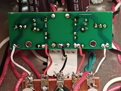

Can you post a photo of the bottom side of that small C4S board?

Hi again - here's the best pic my phone can manage of the underside of the Small Board.
Adrian.

    • Posts: 20290
I think there's either lead free solder here or a cold iron.
When you reflow the solder joint on the middle of the MJE350, hold the hot iron on there for a good five seconds to really let the solder flow out. If you have lead free solder, find some leaded solder!

Hi Paul - solder is lead multicore (see pic!). I reflowed the middle pins again - my iron is only 25W, so that may have been an issue. But it didn't change anything. HOWEVER, having a poke around and being careful to check everything in that area, I found that the link between A6 and (small board) OA had become disconnected at OA - it must have slipped out when I soldered the link at 1U to OA!!
So I'm not infallible after all!
The reading at OA on the small board was now 71v. 1A = 191v;  B-A/B = 0v; IB = 191v and OB = 71. Perfect!
