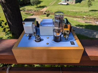

So after spending an unreasonable amount of time polishing the EXOs, lots of drilling and filing to squeeze all that iron in, I arrived at this:
The A2 voltage is a bit high, 485v, leading to a plate voltage on the 2A3 of 277V when adjusted per the manual. So I trimmed them to bring the plate voltage down to 255V and hooked them up with the new N801s. And they sound wonderful. Though I'm still debating dropping the B+ a tad.
