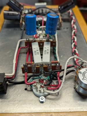

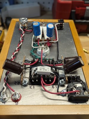

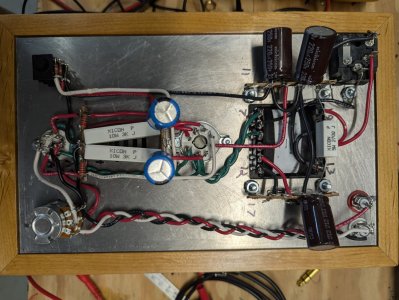

I can barley hear anything on a new build.  I do hear something "music" but it extremely faint.   How do I post a picture? Is this the correct location to ask this question? And you cant post external links????
add and "h" to the beginning to link to the pictures:
ttps://photos.app.goo.gl/dL8h8V2yRyFvNZEj9

Reply #7 on: October 03, 2024, 04:29:42 AM
From the build photos, it looks like either lead free solder was used, or low soldering iron heat, possibly both.
You'll have to look at the products you used to be sure that you have 60/40 leaded solder.  If you do, then crank up the heat on your soldering iron and reheat all of the joints in the amp until the solder flows out, noting that the power switch and the LEDs on the 9 pin socket can usually be skipped in this process.
