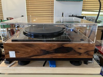

Just bought a new/old Lenco in a near 50 lb. plinth (pictured below).  The Lenco guts were rebuilt with a bunch of upgrades, added a Sorane arm/Hana 'Umami' Blue cartridge and a cover.  Amazing what a properly set up idler table can sound like and it's deserving of the best in a tube phono.  At least that's my thinking. and...

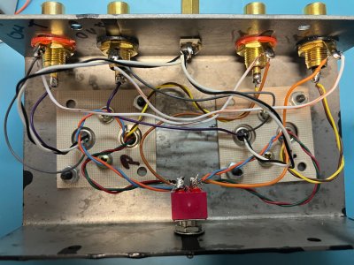

Currently using a Cinemag 3440A at 1:20 (Cinemag claims 150 Ohms) in a eBay kit box made for Cinemag step ups. Poor man's Bob's devices.
https://www.ebay.com/itm/276408327532?_skw=cinemag&itmmeta=01JA1HB1WREH11J2Q1KBEZY5C0&hash=item405b385d6c:g:essAAOSwyLtmC0Ld&itmprp=enc%3AAQAJAAAA4HoV3kP08IDx%2BKZ9MfhVJKnbqgcd4Emy2uiHVw6zw6jaikNxHcIklr9B2dNQ%2FvvxOxTMVAT52ON23ntSpGh09%2F60R4T%2BCxCv4Cc19PaAfalbRDvJ9CKhGbllAGl1S9WtY%2BA6U59oiT5cmJSJaYkIWyUtbtR2%2Bui2JS1OzYhiFx732GGay1%2BVUvnloPGE49Sc9gBPfNCwO3DNnq3Q9X7vo5AVHKwsXSKno6BoMBmIpRYgcuWouO1RPcAMxnCce4UFbGHVEfFI%2Bs40fOCZNKRGx38cpEer8RLd8ijphAKeY5FP%7Ctkp%3ABk9SR8CerLHQZA
$30 for the box plus the transformers and it sounds great.  And no hummmmm.
Would prefer step ups built into phono stage and maybe the 'better' Cinemag CM-1254.  Looks to be an easy task as the hole size is just right in the Eros 2.
Looks to be an easy, straight forward kit compared to others I've built.  I'm good with populating circuit boards, it's attaching all of those stacked transformers and plastic grommets in small spaces as in the two S.E.X amps that are a pain.

I added a switch to the front of the 'poor man's Bob's devises' so I could use both.
Anyone wishing to make their own high quality step up box using Cinemag ore even Octal  plug-in step-up and maybe even the Sowters should check up the offerings at the ebay seller at the above post and link.  $30 for everything you need except the transformers themselves.
