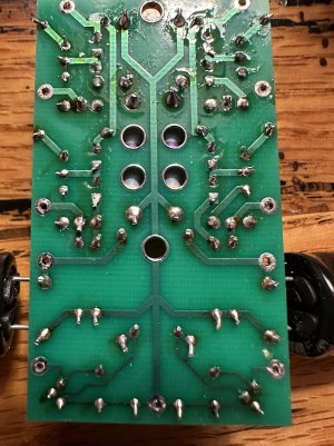

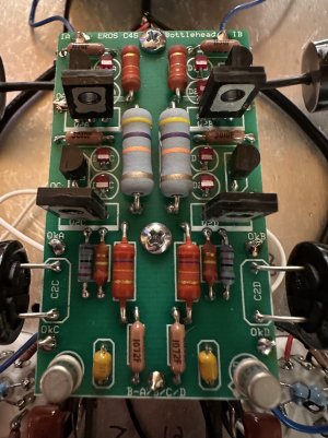

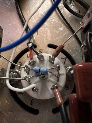

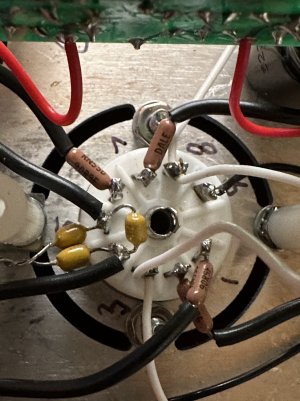

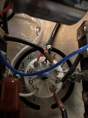

Added a couple of build pics to start.  A + B sockets and top of C4S.

Socket C and bottom of C4S

Can you very carefully measure the DC voltages at pins 4 and 5 of one of the front two sockets? (you don't need to do both)
On the front C4S board, that looks like either lead free solder or very low heat, possibly both.

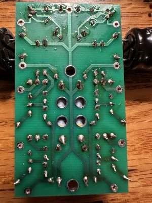

Offline phatfish
    • Posts: 37
Reply #9 on: October 14, 2024, 05:49:16 PM
I reflowed all but the LEDs on the C4S board, and I basically have the same voltages.   :-\
Of possible note many of the discrepancies side to side seems to have switched from before (OC vs OD for example)

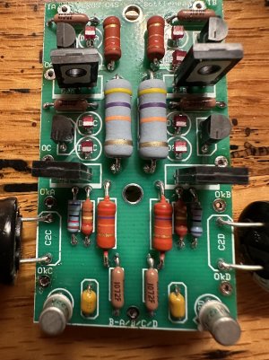

Here are my new values and some updated shots of the C4S board.

    • Posts: 9805
Reply #10 on: October 14, 2024, 07:16:02 PM
What's with the center leg of what looks to be Q2A? I see a hole where there should be a lead with solder filling in the pad on the underside.
Offline phatfish
    • Posts: 37
Reply #11 on: October 15, 2024, 02:56:10 AM
I took the board bottom from two angles for this reason.  No soldering was done between the two pics.  It does really look like a hole from the 1st pic!  But check out the 2nd bottom pic  (board is flipped).

    • Posts: 20337
Reply #12 on: October 15, 2024, 04:27:31 AM
You have the 10.7K EQ resistors installed in the servo sense area of the circuit rather than the 174 ohm resistors that belong there.  This is both preventing the EF86 tubes from drawing current and your EQ will be way, way off.
