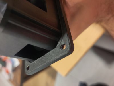

Reply #3 on: October 17, 2024, 09:47:19 AM
I might have in fact overtightened the gasket here, not sure if it is possible to recover or put an extra gasket

It is a Subette that is rattling.
I was thinking it was gasket, or seal, or something. It does not look like it is a gasket, it seems too seal fine
But I think it is a rubber that is rattling on the driver. Lightly touching it makes it stop rattling. Just trying to understand is it normal or not. Is the driver damaged? If rubber part is damaged, can it be glued, or does the driver need to be replaced?
