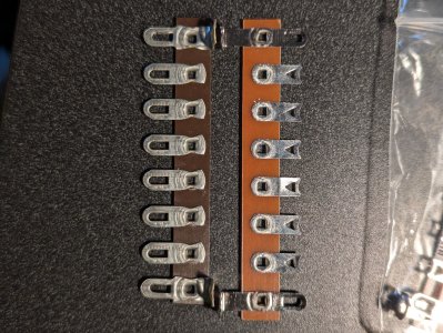

These are them vs the Keystone:

Those sure look a lot like the Kobiconn strips we were getting from Mouser, do you have a link to where you got these?  It's possible that a few vendors here and there have some quantities of these left, but I'd be worried about the long term supply.

So, to clarify, the ones I had trouble with were the ones on the left, which I originally got in my kit, and sourced replacements from Digi-Key (36-831-ND).
The ones on the right I picked up from my local electronics store (Jaycar), who have their own distribution (Electus) but to my knowledge they don't list the manufacturer anywhere (they just slap their branding on the packet).
https://www.jaycar.com.au/8-way-tagstrip/p/HM3308
The other place I've seen them is Wagner Electronics, which is the customer facing site for WES distribution. They list them as Daichi. No idea if that's correct or what their supply is like.
https://www.wagneronline.com.au/TAG-STRIPS/crossover-components/speaker-components/audio-speakers-pa/TAG8-6856/2990/pd/
That's the consumer website - the trade website requires a login. Be warned their search and filter functions are pretty broken.
