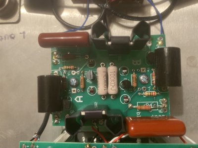

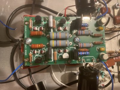

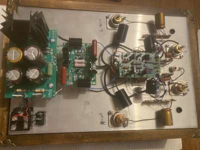

Offline jaloyn
    • Posts: 8
Reply #13 on: November 10, 2024, 12:46:53 PM
OK Paul, I attached some images of my Eros 2.  Hopefully, they will reveal something significant.
John
Reply #14 on: November 10, 2024, 01:26:08 PM
I immediately see most of the PC board solder joints do not look soldered.
