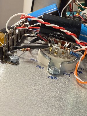

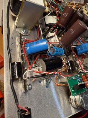

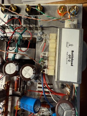

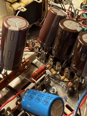

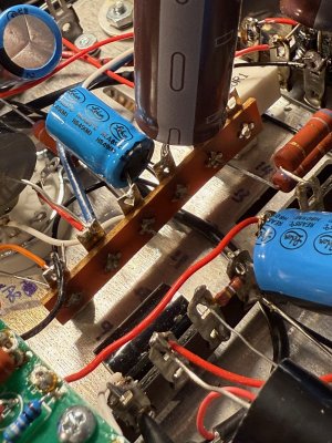

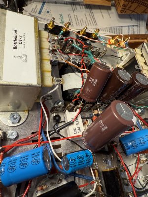

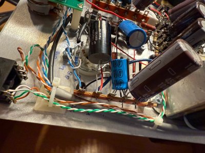

Thanks so much for the quick reply! I've been out of town and now just returned to take the measurements.... and miraculously both channels are working right now, both sets of C4S LEDs are lit. So the pin9 DC voltages are 2.25v for each. But that's not helpful for diagnosis now. Naturally these things fix themselves as soon as one asks for help, but I'll take it and now enjoying the sweet music!
I'm assuming the most likely cause is a tenuous solder joint somewhere.
I wanted to still post the pics I had from before I left, and in the hopes that this could help anyone else with the same problem, and if you happen to spy a bad joint that I should target.
Wei
If you have a soldering iron with an adjustable temperature, turn it all the way up.  If you don't have an adjustable temperature soldering iron, then the iron you have just doesn't get hot enough.
