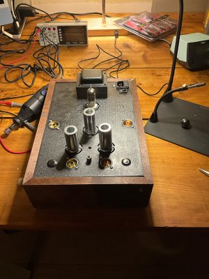

Post photos of your build so far and we can have a look.
Offline Allen
    • Posts: 5
Reply #2 on: November 16, 2024, 10:43:20 AM
Thank you.
I did powder coat the plate, but I also cleaned it with a drimmel and acetone wherever a metal part contacts it--bare metal on bare metal.

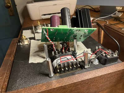

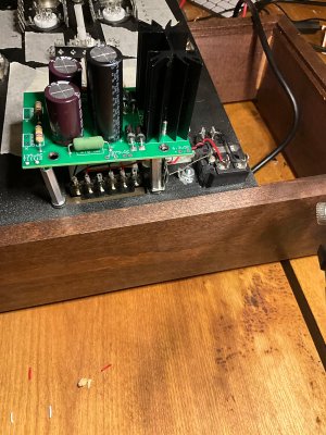

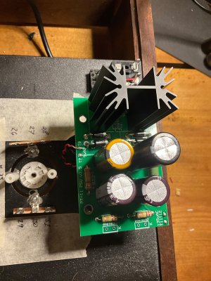

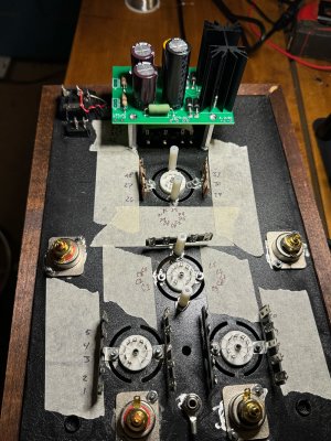

Reply #3 on: November 16, 2024, 02:28:37 PM
You are missing some parts on your power supply PC board.
Found it. I overlooked that step probably ten times going back through my work.
vDC tests right. Thank you again
