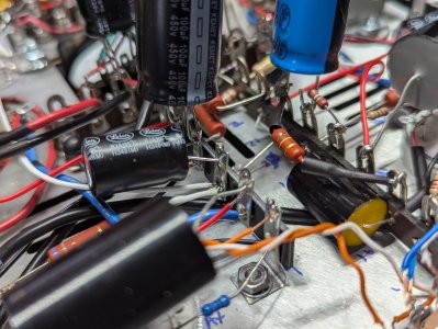

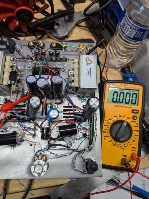

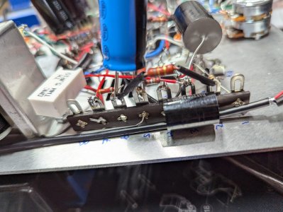

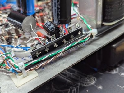

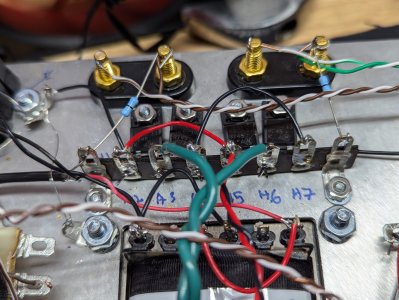

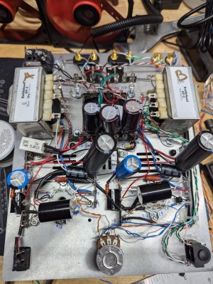

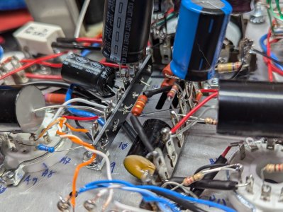

Hello everyone, I just finished assembling a S.E.X. kit and during the process of checking resistance found some outliers. I did try and clean up some ugly looking joints but to no avail. Here's the offenders:
T15: 6Ω
T30: Starts around 100Ω and climbs, I stopped measuring when it hit 200Ω (denoted by 100++Ω)
T31: 100++Ω
T32: 100++Ω
H2: 100++Ω
H4: 100++Ω
H7: 100++Ω
Attached are a few pictures of the build, do note I did take out the .1Ω 5W resistor as it had the ugliest of joints. It was a tough spot for me to get it back in so I gave him some legs.
Thanks in advance!

Reply #5 on: November 24, 2024, 06:15:59 AM
Can you post a picture of the screen of your meter measuring terminal 31?
Offline alecksbee
    • Posts: 12
Reply #6 on: November 24, 2024, 06:26:09 AM
Reply #7 on: November 25, 2024, 02:25:51 PM
If you move the meter to the beep setting, does this connection produce a tone?
I would suspect issues with the shielded twisted pair wiring causing a short between the heater wires inside the STP and the drain wire/shield that is used to shield it.

Earlier today I went through all of the instructions again and discovered that the leg for the 8.2KΩ resistor wasn't soldered in to 20L at all! Fixed the majority of the resistance checks. There's still a few ones remaining though:
H3: 1800Ω
H4: same odd rising number, up at 4M it reads 0Ω
H7: same as above
EDIT: I did go back and tested everything with the beep setting, did not beep on T30, however pretty much all my previous readings were bad? They're similar to the original post now. The meter does beep when I put it on T15. Very odd

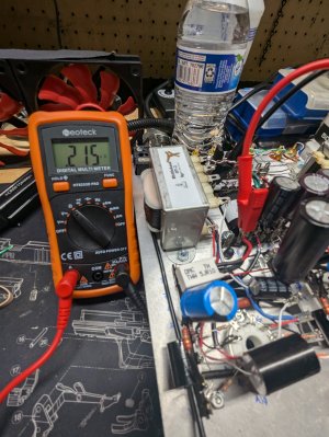

Reply #14 on: November 27, 2024, 05:27:38 AM
Can I see a picture of what this looks like on your meter?
Definitely do not mess with any of the wiring yet.
Sounds good, here's what it stabilized at with the new meter, I took a short video as well below:
https://streamable.com/sbmlob
