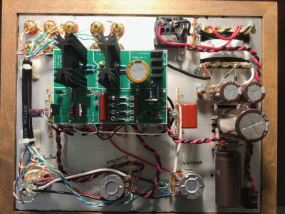

Could you post a photo of your upgrade board build?

Sorry my photography skills are,,,,,,mediocre.
Does this show what you need?

The solder joints on the zener diodes need a lot more heat.  If you can turn your iron up all the way, that might help.
Are the voltages coming out of the low voltage board looking good? You should see about 6V at the H1 and H2 sets of pads.

Paul, I'm getting 6.31 V at H1, and 6.33 V at H2.
Hmm, I'll be OK putting 899 degrees on the Zeners? :o
My usual MO has been a 4-5 count while the iron is applied to the object and board attachment point at ~710 degrees. Much lower than that and I was not getting any flow. Brand new Hakko with Hakko tips.
I don't need to dismount the board to solder from "underneath"? Dumb question I guess, as I assume doing aggregates all at once are just an efficient time use, right? In other words I can solder from the top as in the picture I sent?

I solder at 899.  Do double check the instructions for raising the temperature if you have a Hakko station.  It's easy to think you are raising the temperature when you're actually in the calibration menu, and increasing that lowers the tip temperature.

I dialed the Hakko up to maximum. Soldering this way was just like metal on metal soldering with a torch, which I did plenty of in a prior lifetime. I made it to a mental 1001 count and the solder flowed.
Did the zeners again.
Unfortunately, my measurements look, in essence unchanged.
6U--126.9V
16U--129.2V
H1--6.33V
H2--6.31/v
B+ Reg TP--190.1V
How now?

Can you measure the voltage on each banded end of each zener diode?

ZD1–186.3V
ZD2–140.3V
ZD3–93.5V
ZD4–46.6V
With the common on the volume pot.

I don't see anything particularly concerning there, I think you're good to go.
